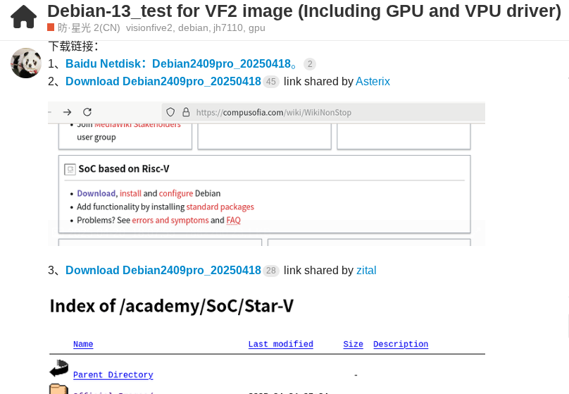

If you want to upgrade StarFive’s official debian2409 to debian13, you can refer to here or here。 I personally made it for reference only.
