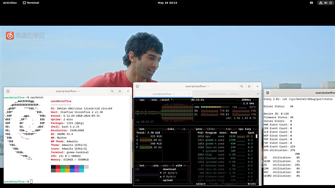

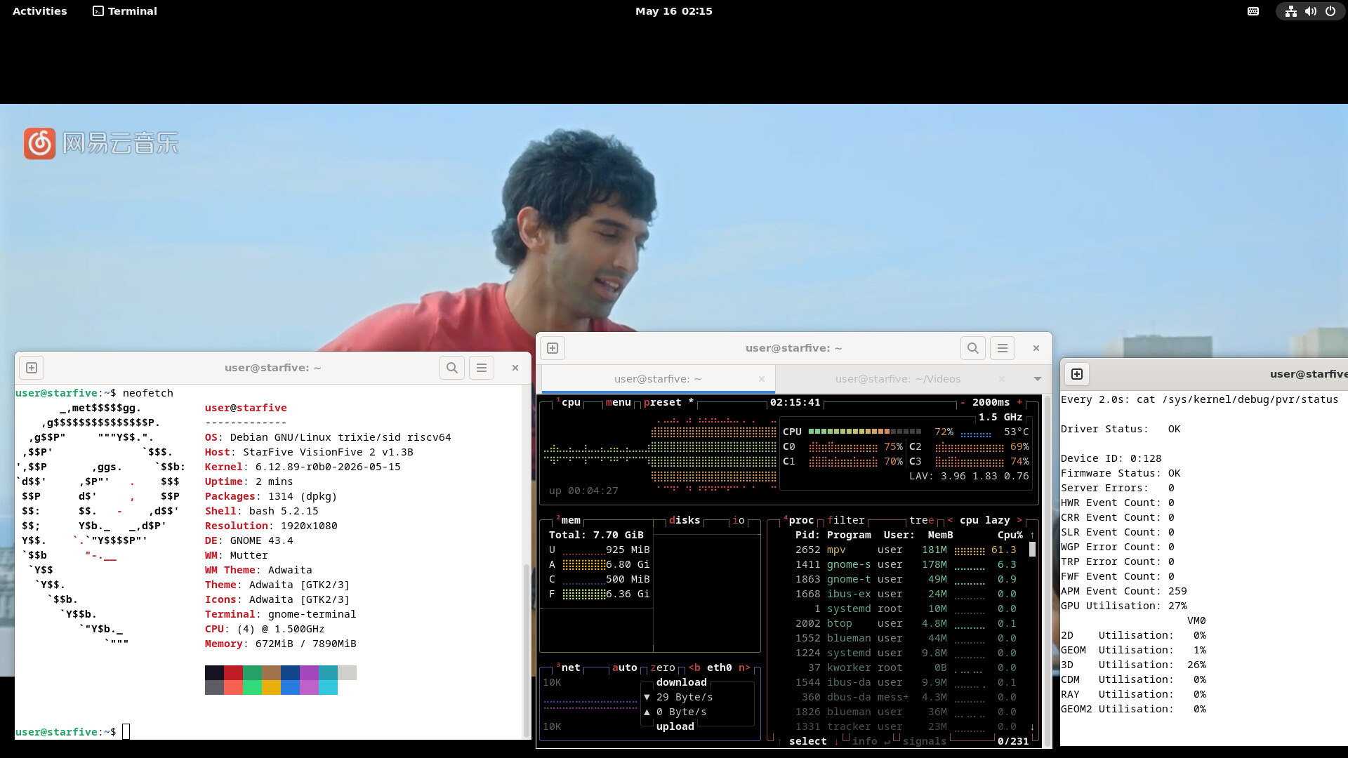

After upgrading to Kernel 6.12.89, gnome runs smoothly, GPU runs smoothly, and HDMI sound is normal; Occasionally unable to find nvme on VF2; VPU not be working, MPV plays local videos, before upgrading: CPU<30% GPU<30%, after upgrading: CPU>70% GPU<30%.

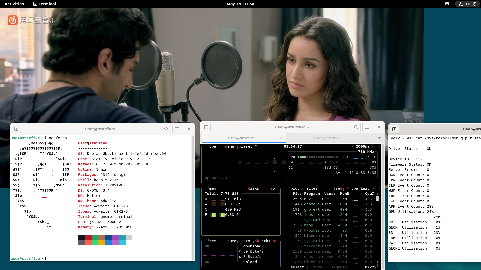

Test debian202510 for VF2(Not upgraded to debian13.5). After upgrading to Kernel 6.12.90, gnome runs smoothly, GPU runs smoothly, VPU runs smoothly. :+1:
Occasionally, it can be ignored.
