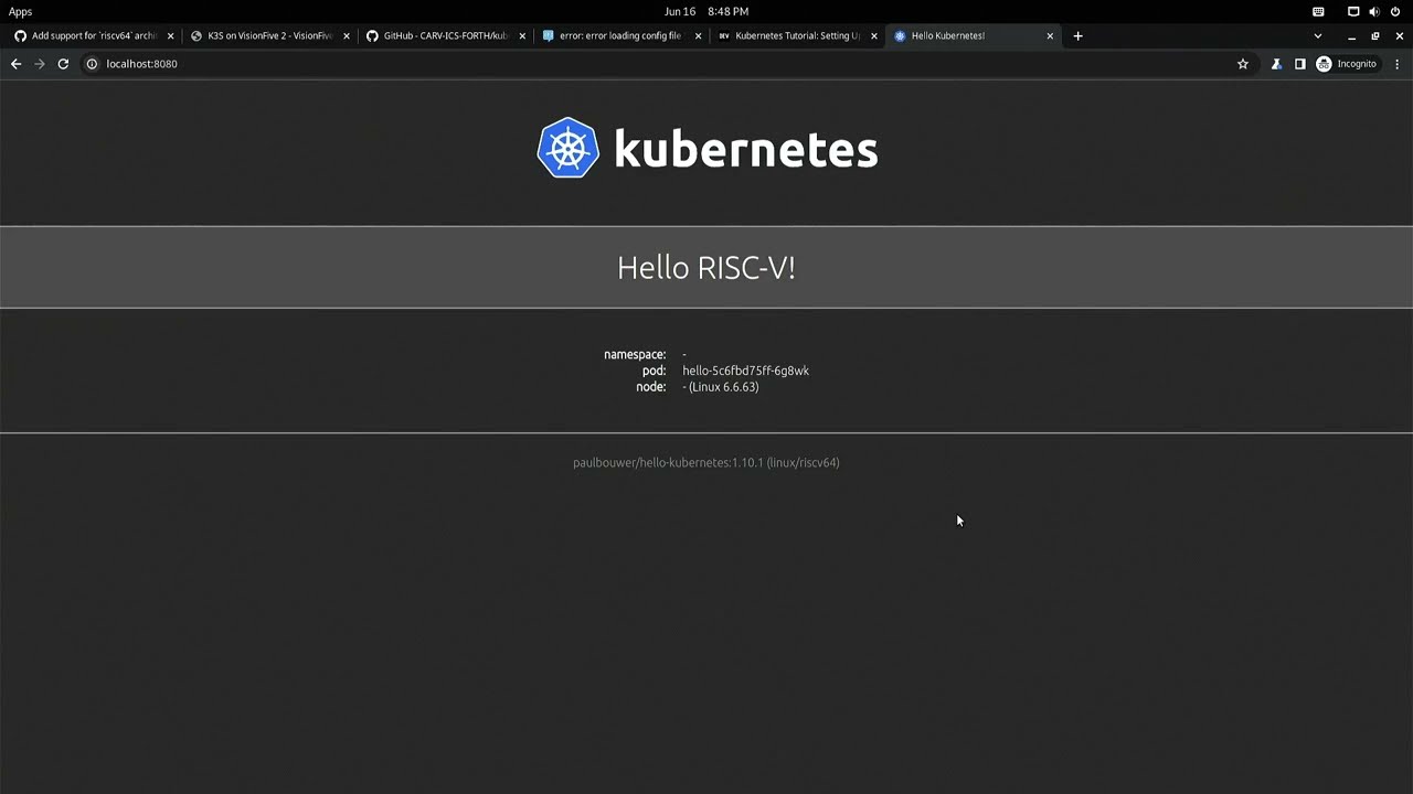

I tried the instructions to install the server, but they are probably written for a user with root privileges.
As a regular user, I did it like this.
wget https://github.com/CARV-ICS-FORTH/k3s/releases/download/20241024/k3s-riscv64.gz.aa
wget https://github.com/CARV-ICS-FORTH/k3s/releases/download/20241024/k3s-riscv64.gz.ab
wget https://github.com/CARV-ICS-FORTH/k3s/releases/download/20241024/k3s-riscv64.gz.ac
cat k3s-riscv64.gz.* | gunzip > k3s
chmod +x k3s
sudo mv k3s /usr/local/bin/k3s
curl -sfL https://get.k3s.io > k3s-install.sh
INSTALL_K3S_SKIP_DOWNLOAD="true" bash -x k3s-install.sh
Setup for the config file, as explained here: https://devops.stackexchange.com/questions/16043/error-error-loading-config-file-etc-rancher-k3s-k3s-yaml-open-etc-rancher
export KUBECONFIG=~/.kube/config
mkdir ~/.kube 2> /dev/null
sudo k3s kubectl config view --raw > "$KUBECONFIG"
chmod 600 "$KUBECONFIG"
Add the following line to .bashrc, .profile, or .zshrc.
Restart your terminal, or restart the whole system.
Install Hello RISC-V.
kubectl apply -f https://raw.githubusercontent.com/CARV-ICS-FORTH/kubernetes-riscv64/main/examples/hello-kubernetes.yaml
kubectl expose deployment hello --type=ClusterIP --name=hello-world-service --port=8080 --target-port=8080 -n default
kubectl port-forward svc/hello-world-service 8080:8080 -n default --address localhost
Open a browser and navigate to localhost:8080
