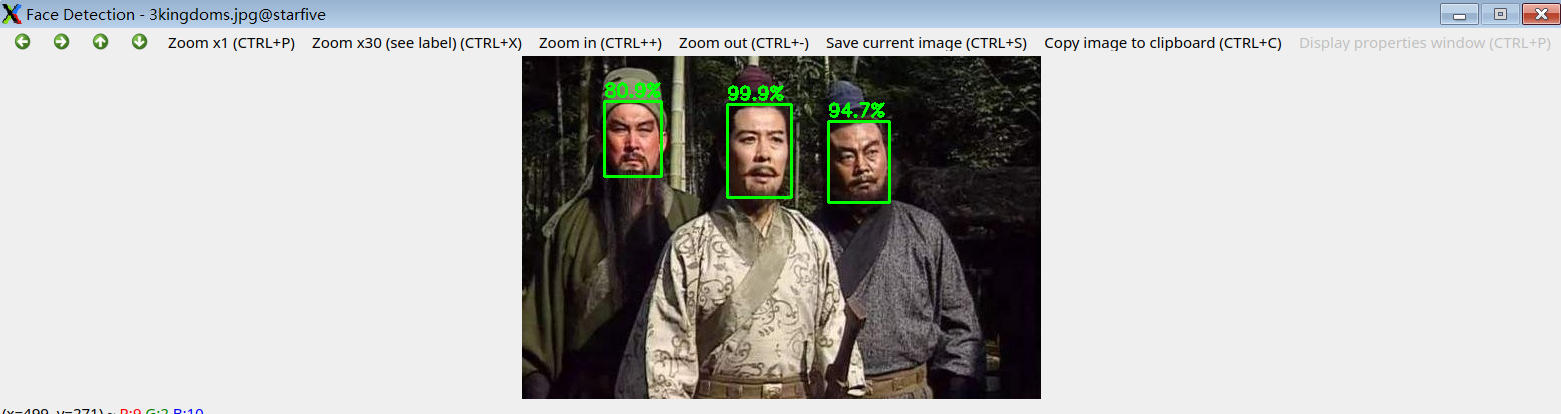

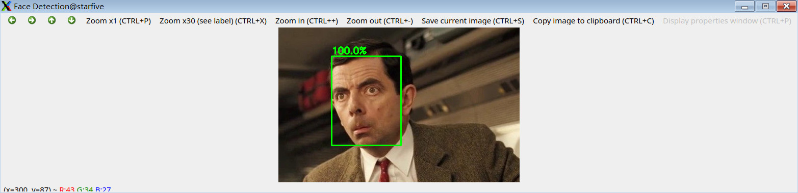

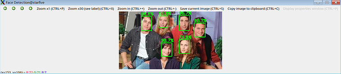

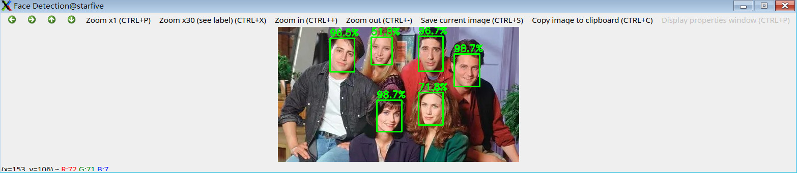

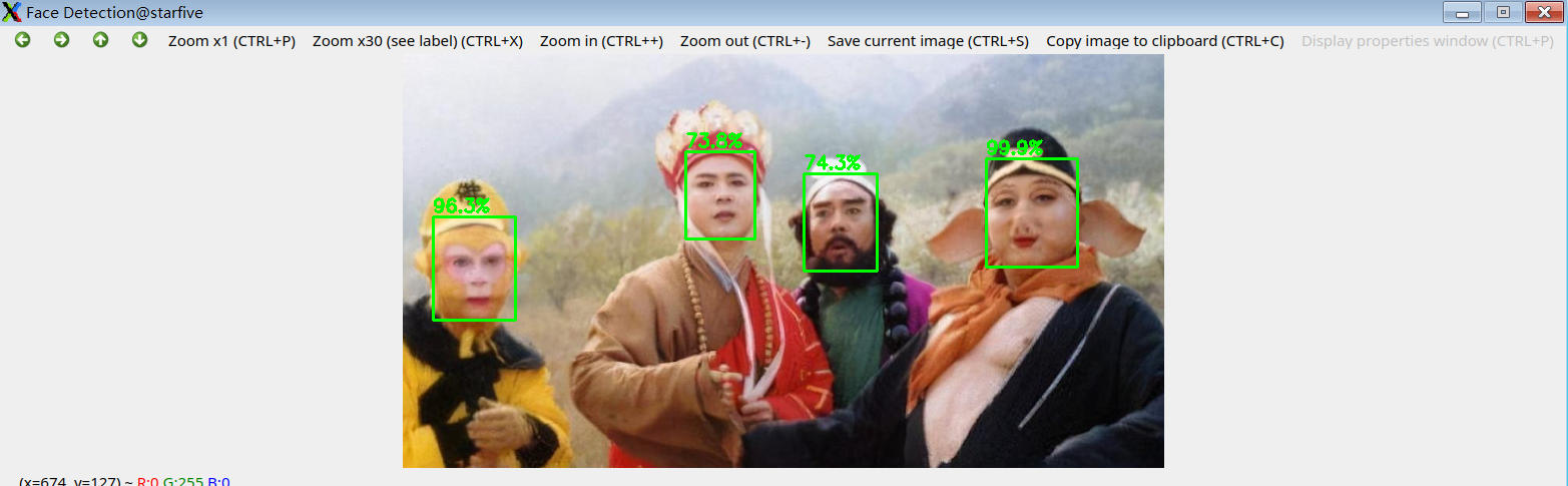

 for i in range(detections.shape[2]):
     confidence = detections[0, 0, i, 2]
     if confidence < 0.5:
         continue
     # 映射回原图坐标
     box = detections[0, 0, i, 3:7] * np.array([w, h, w, h])
     (x1, y1, x2, y2) = box.astype("int")
     cv2.rectangle(img, (x1, y1), (x2, y2), (0, 255, 0), 2)
     cv2.putText(img, f"{confidence * 100:.1f}%", (x1, y1 - 5),
                 cv2.FONT_HERSHEY_SIMPLEX, 0.6, (0, 255, 0), 2)
 # 5. 弹窗显示
 cv2.imshow("Face Detection", img)
 cv2.waitKey(0)            # 按任意键关闭
 cv2.destroyAllWindows()
保存代码。
效果
  • 终端运行指令 python3 fd_dnn.py 弹窗显示识别结果,按任意键关闭窗口。
  • 识别效果如下
