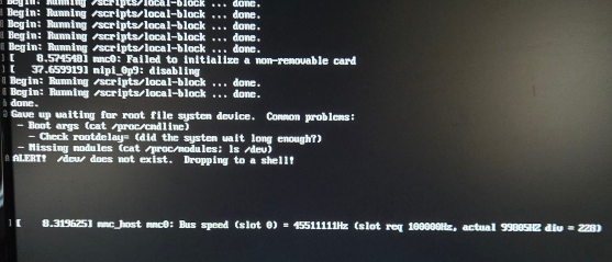

Unfortunately it’s not working for me, VisionFive 2 v1.2.
Anyone else with a v1.2 board?

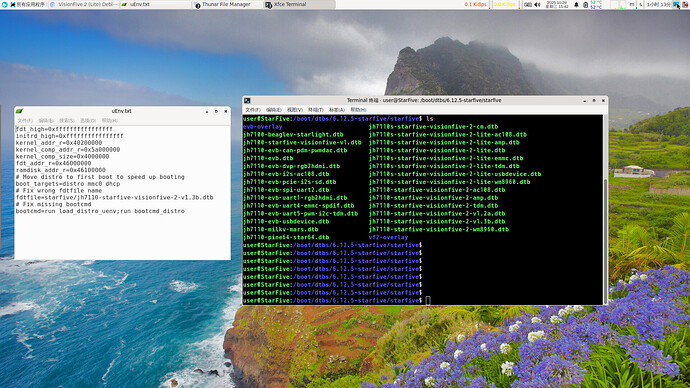

I may have found the reason why TF cannot start on VF2_1.2a. You try.
/boot/uEnv.txt
fdt_high=0xffffffffffffffff
initrd_high=0xffffffffffffffff
kernel_addr_r=0x40200000
kernel_comp_addr_r=0x5a000000
kernel_comp_size=0x4000000
fdt_addr_r=0x46000000
ramdisk_addr_r=0x46100000
# Move distro to first boot to speed up booting
boot_targets=distro mmc0 dhcp
# Fix wrong fdtfile name
fdtfile=starfive/jh7110-starfive-visionfive-2-v1.3b.dtb
# Fix missing bootcmd
bootcmd=run load_distro_uenv;run bootcmd_distro
fdtfile=starfive/jh7110-starfive-visionfive-2-v1.2a.dtb
Changing dtb to 1.2a still gives me the same error.
