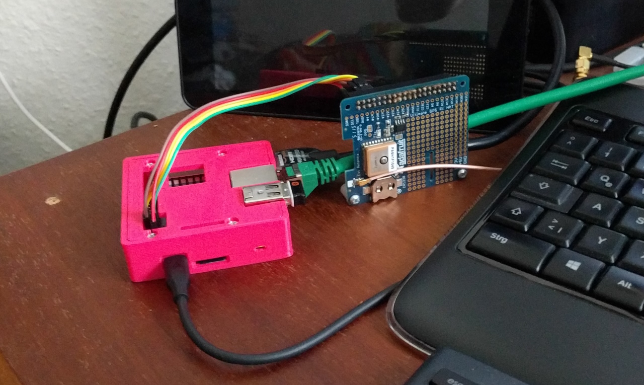

In these two photos from 2016 and 2019, I used the usual pins but could have used others.
@SunWukong this is true, but I already have a spare Uputronics HAT and would love to get an NTP server using it up and running on the Visionfive 2. And I really don’t like the system monopolising UART0, anyhow.
I can understand that, I use two HATs from Uputronics myself.
