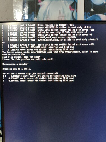

I tried this new image, but it hanged in another part:

That is what it says on the hdmi
Friends, I have a similar problem. How can I help speed up the process?
try changing in /boot/uEnv.txt verbosity=4 to verbosity=8 and post the output from debug.
most likely there is an incorrect setting in dts, I will try to build kernel 6.6 to check.
