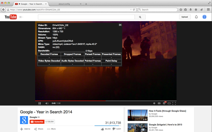

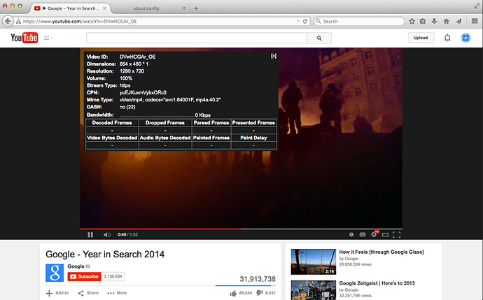

One thing you can try is to use h264ify. h264 uses less CPU than VP9, but it’s still only a marginal difference.
I don’t know if the VF2 can also use V4L M2M, but that would mean that hardware accelerated video decoding (now only h264) might get supported easily with Firefox.
Correct as of now, you can add this h264ify into firefox so that the streaming could be translated to h264 which is supported by JH7110 hardware decoder.
For V4L M2M, we are still WIP for that.
