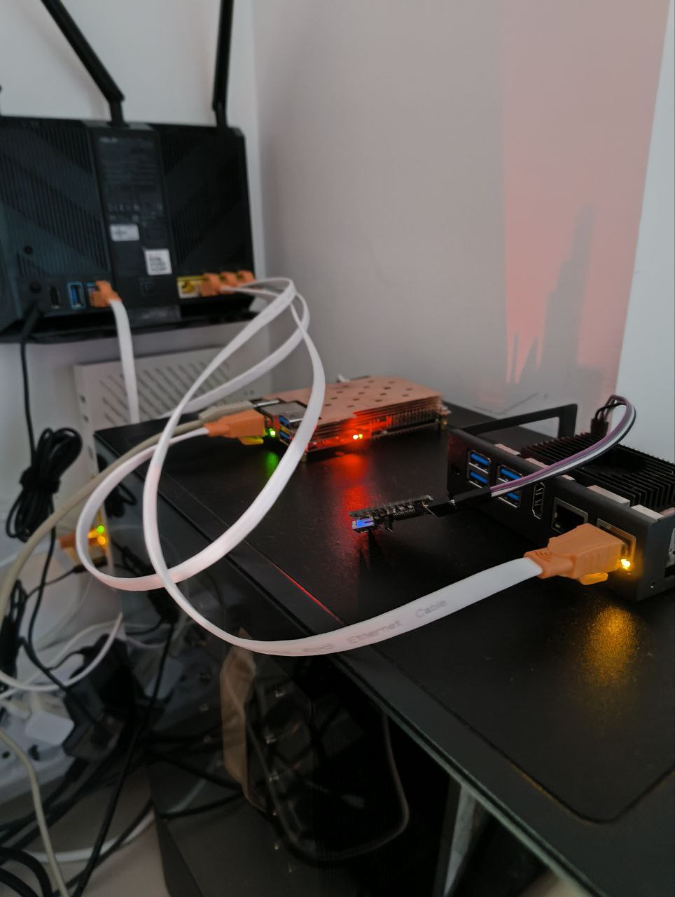

left orange pi with green light and in the right the vf2 with orange light

hi, zital
I just conducted a test on my VF2.I have two local area networks, 100Mbps and 1G, at home, My VF2 has both gigabit network interfaces, When a gigabit network is connected, the light is orange, and when a 100Mbps network is connected, the light is green. Both network interfaces are the same. I didn’t test the speed of VF2’s network.
I heard that some VF2s have one 100Mbps and one Gigabit.
The system I use for my VF2 is Debian2409pro (debian13 testing).
