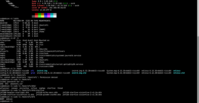

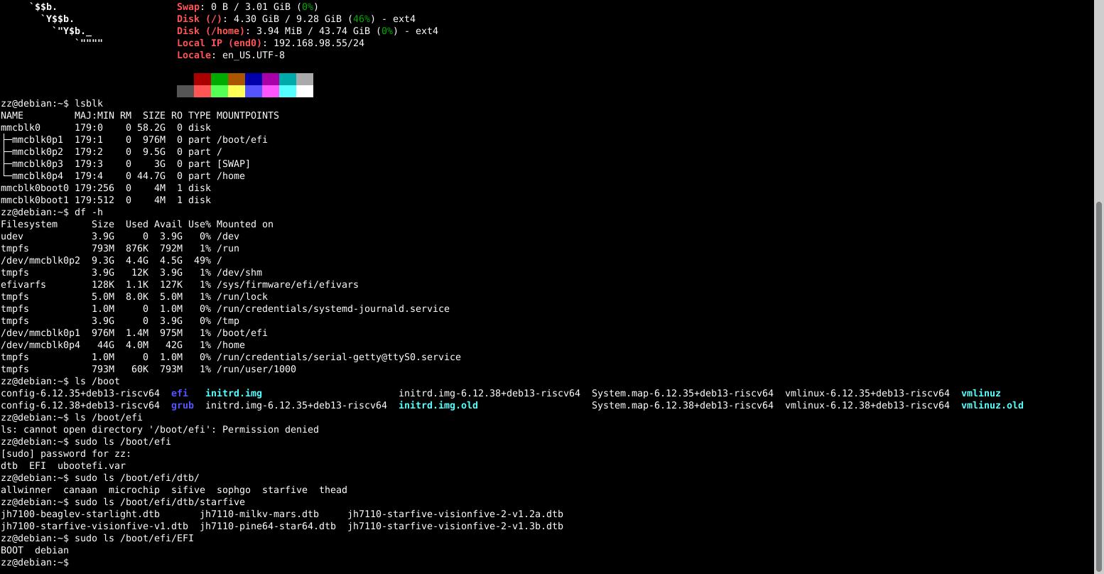

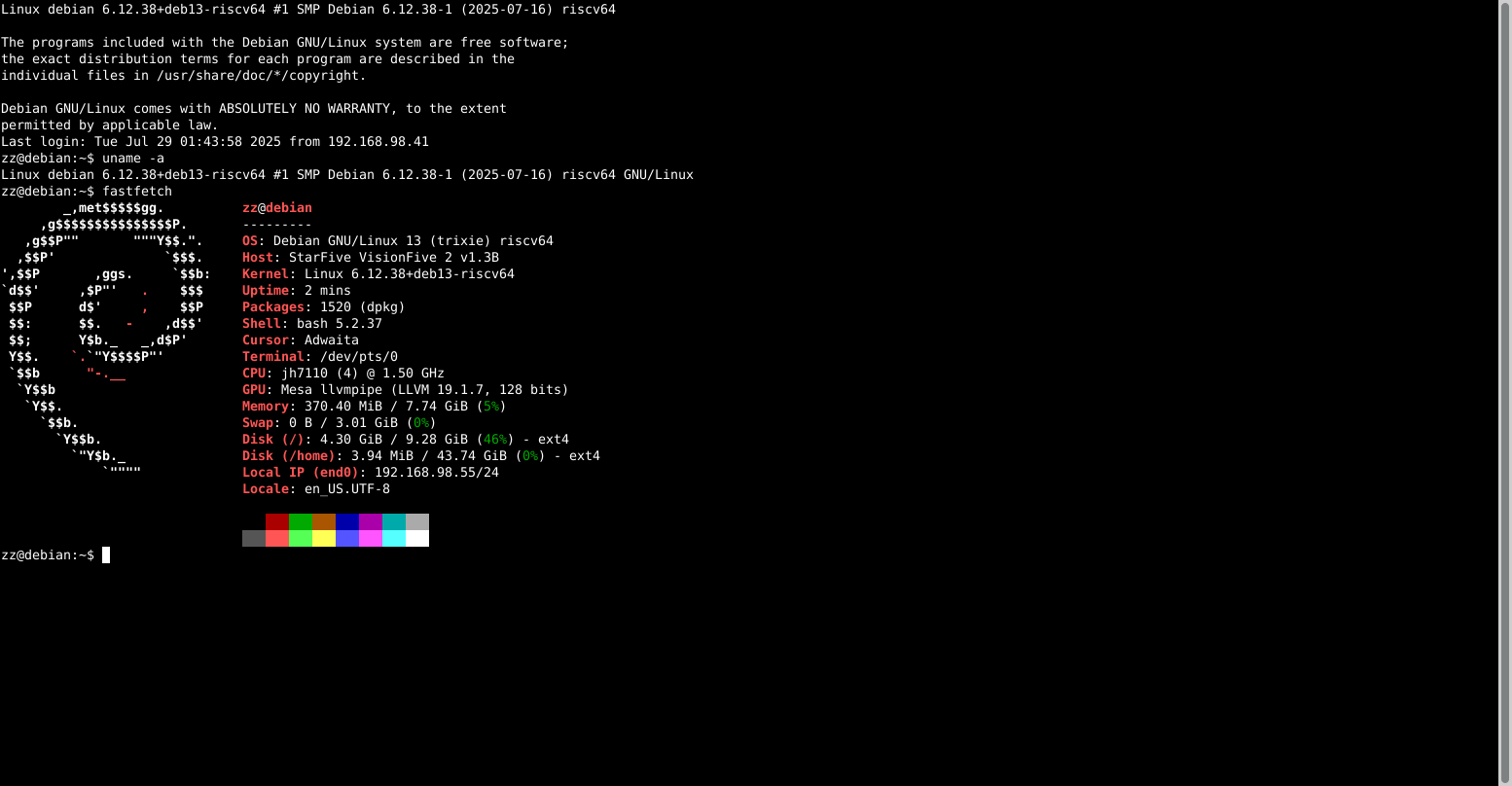

GRUB boot, No HDMI, NO GPU VPU ,No graphical interface。
https://wiki.debian.org/InstallingDebianOn/StarFive/VisionFiveV2
