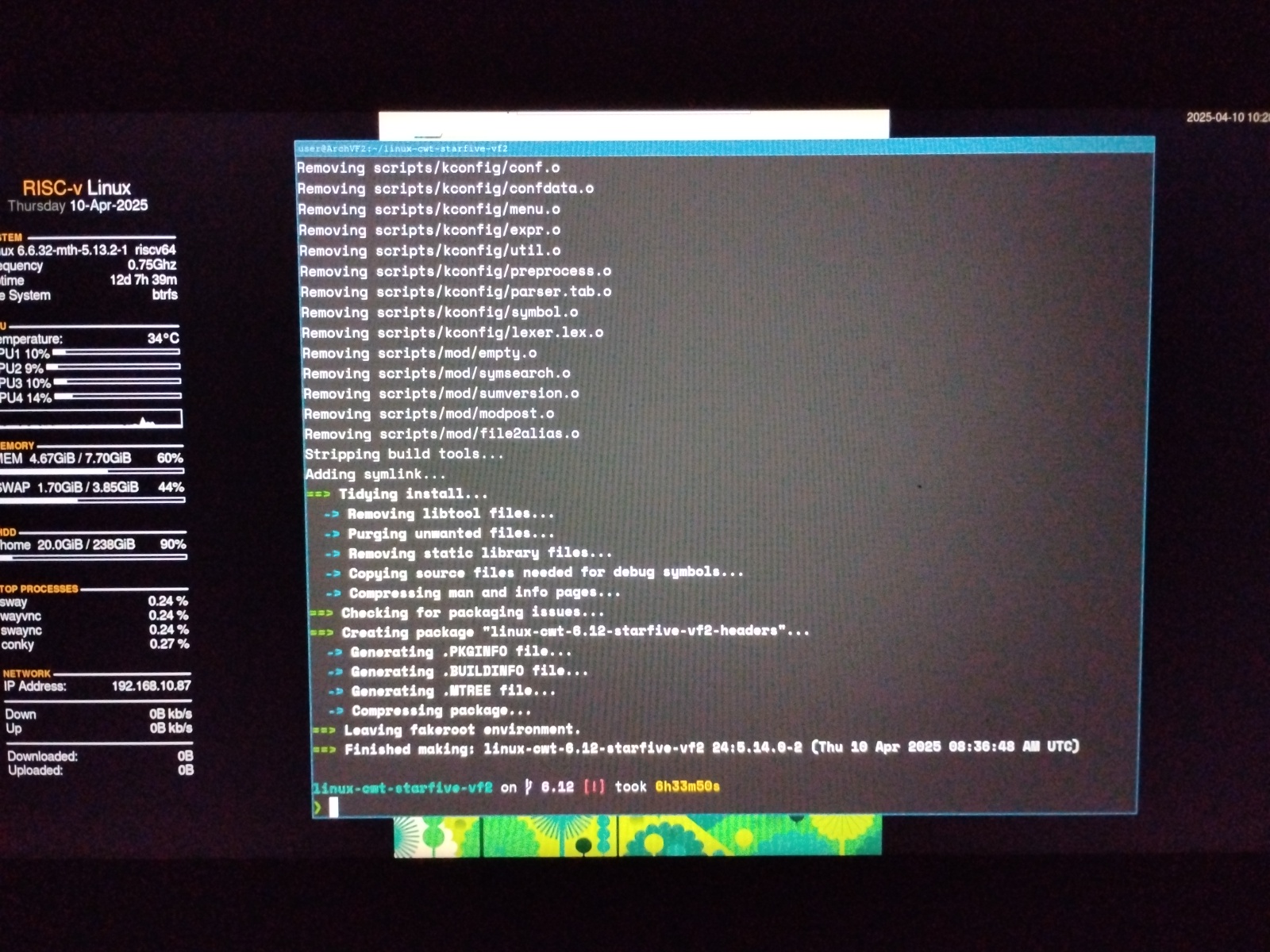

I am working on compiling on the actual VF2 right now.
  1. I had to install a dependency which was not required before “ccache”
  2. and am having one stoppage in the PKGBUILD at one of the $src/test/xxx packages…
will continue to work on it…
I have had exclude all patches after patch-11-12 to make the build system not error on the makepkg --nobuild --skipinteg ( because I did not remove the crc checks ) and am about to try the full compile.
My current kernel is your previous 6.6 build and I have only added a SCSI_transport_FC flag and a qla2xxx driver module for a fibre channel card i sometimes use via pci to connect to a clusterFS.
will let you know.
eh? ccache is not required, but if the build script (PKGBUILD) found it, it will try to use it, so when you rebuild it again after make some changes, it will finish a lot faster.
This is weird, can you try sudo pacman -Syu before makepkg? I built it on my VF2 many times before made a release, and they were all pass. How about justmakepkg -o?

6 and a half hours later …
I will add your solution to the PKGBUILD, thanks!
