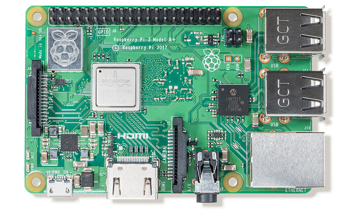

The boards with regard to connector placement look amazing similar (and I’m sure that took a lot of effort to make happen):
e.g. RPi 3B+ vs VF2L
I wonder if some of the pre-existing RPi3 RPi 1B+, 2B, 3B and 3B+ cases would work for the VF2L ? There would be an open hole in the RPi cases where the 3.5mm Audio Jack is, but looking on the bright side, that would probably help with extra airflow. The placement of heat sources (IC’s) on each board is different, so that would probably eliminate a large number of cases (the ones with with milled aluminum pads over each IC on the RPi 1B+, 2B, 3B and 3B+ PCB’s). And micro-USB is used on the older RPi 1B+, 2B, 3B and 3B+, instead of the now standard USB-C on the VF2L, for the power connection would probably eliminate even more cases (unless you are willing/able to file/reamer the opening bigger).

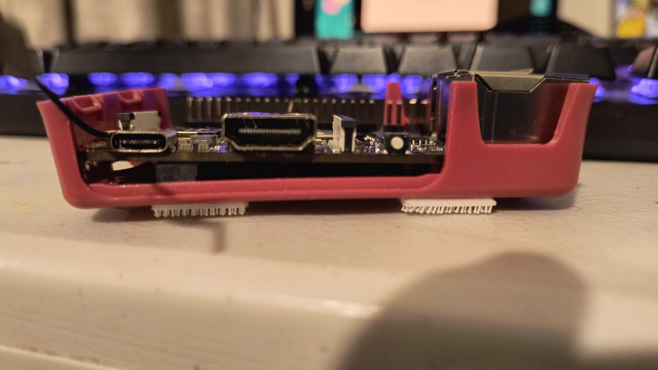

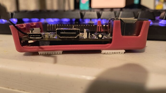

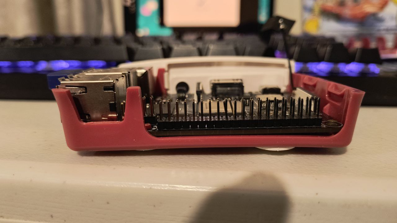

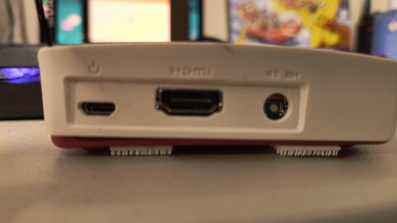

Here is the original case for RPi 3B+. It would’ve fit perfectly well if there weren’t the M.2 part. And micro-USB hole should’ve been filed to the shape of type-C. Otherwise it fits just fine
