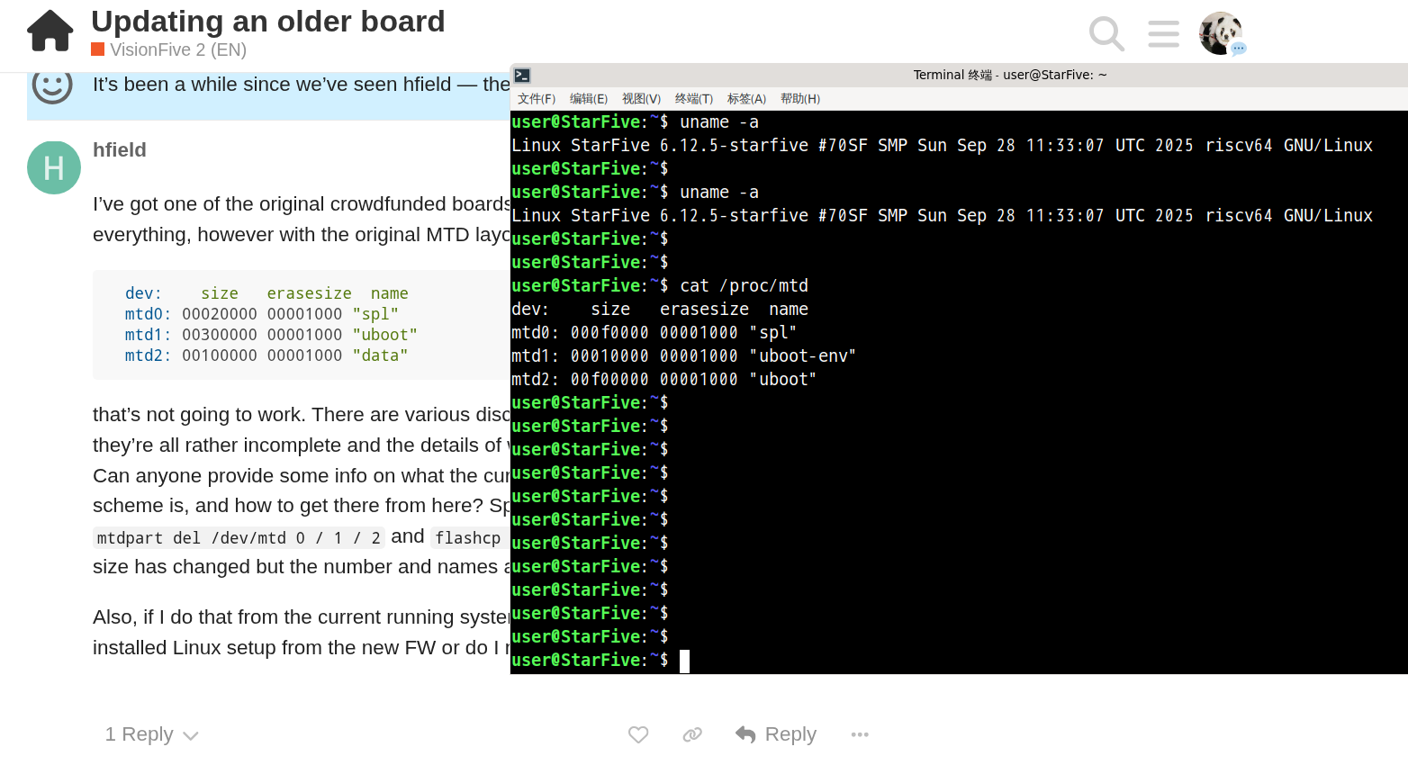

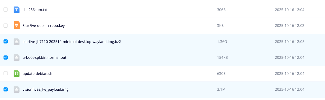

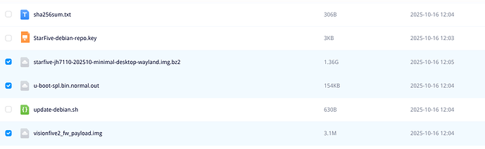

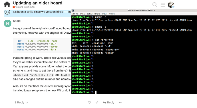

Using the latest system vf2-debin 202510 requires the corresponding version of spl uboot, and they are all in the same download directory.
The safest way to upgrade SPL U-Boot from the original version of VF2 to the latest version is using USB-to-serial.
Thanks! So the bootloader-recovery process really seems intended for bricked devices and is kinda complex, I’ve got a bootable, running system so I was hoping to avoid all that and do it from the CLI. From your screenshot it looks like it’s just a case of getting from the original:
dev:    size   erasesize  name
mtd0: 00020000 00001000 "spl"				// 128kB
mtd1: 00300000 00001000 "uboot"				// 3072kB
mtd2: 00100000 00001000 "data"				// 1024kB
to the new:
mtd0: 000f0000 00001000 "spl"				// 960kB
mtd1: 00010000 00001000 "uboot-env"			// 64kB
mtd2: 00f00000 00001000 "uboot"				// 15350kB
which should be achievable via the following:
mtdpart del /dev/mtd 0
mtdpart del /dev/mtd 1
mtdpart del /dev/mtd 2
mtdpart add /dev/mtd "spl" 0x0 0xf0000
mtdpart add /dev/mtd "uboot-env" 0xf0000 0x10000
mtdpart add /dev/mtd "uboot" 0x100000 0xf00000
flashcp -v u-boot-spl.bin.normal.out /dev/mtd0
flashcp -v visionfive2_fw_payload.img  /dev/mtd2
Does that seem about right? Then reflash the SD card with the current Linux release and restart.
