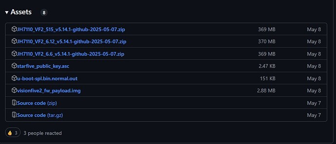

Can someone explain to me why on the starfive github page I find 3 zip files, example “JH7110_VF2_6.6_v5.14.1-github-2025-05-07” for 3 different kernels?
I was used to download the classic sdcard.img and the two files for uboot and spl and do the flashv command as per the guide in short.
can someone explain to me why there are 3 .zip files, thanks
515、6.12、6.6 It corresponds to three different Linux kernels.
So in the official starfive repo, in addition to the files related to uboot and spl updates, there are three kernels available? Sorry, but I was used to finding only the sdimage.img file and the two files to update uboot and spl.
