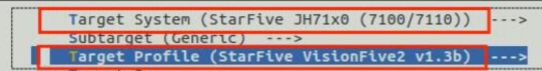

Hi @lzzhzh
This is our board version, Attached screenshot

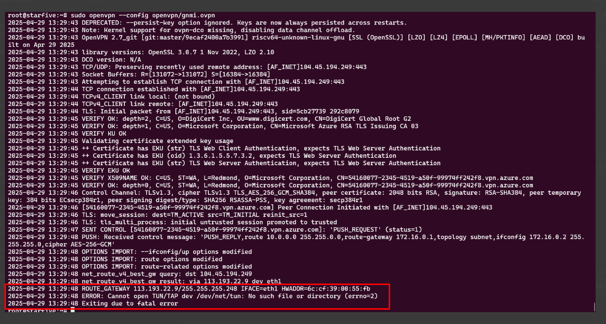

Hi @lzzhzh
This is the error we are encountering on the Startfive board using the Debian OS for the OpenVPN client.
You need to enable CONFIG_TUN and CONFIG_TAP and rebuild the Linux kernel
Can you please share the steps to enable, it will very usefull for us
