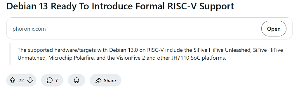

I suggest you don’t tinker with VF2 for now.
There is news these days that debian13 for riscv64 will release its official version on August 9th.The device directory supported by the new version includes VF2。So I suggest you wait until after August 9th…
Because I saw that the news and videos of debian13 for riscv64 are in Chinese, you need to search for the English news yourself. :grinning:
