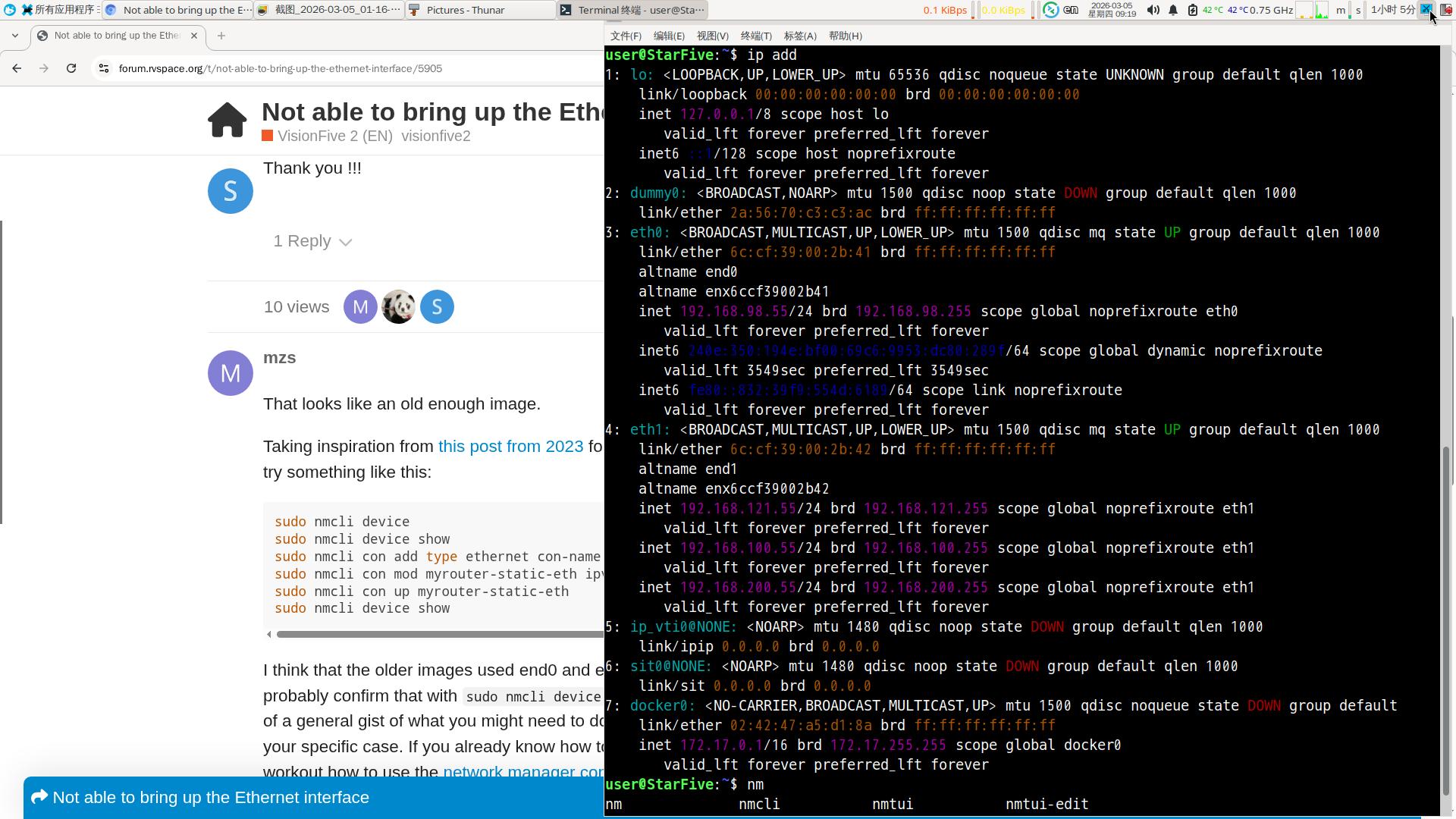

I guess from here that you are using StarFive Debian, probably a version from before 2024. Its latest version is Debian 202510, maybe you can try flashing the new version.
The new version is on the left side here. Debian 202510 requires using the new U-Boot SPL.
I thought about it again, Debian now doesn’t use ifconfig to set up the network by default; you should use tools like ip add or nmtui.
