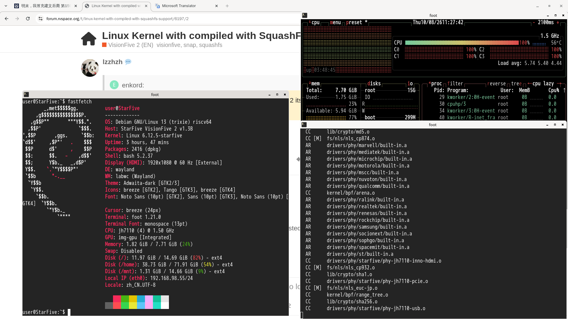

Usually 2-3 hours, mainly depending on. config, there are also those that exceed 24 hours. What I recently compiled is

Up until recently, I was building my kernels on VF2L on an SD card. Definitely doable in 1-2 hours.
