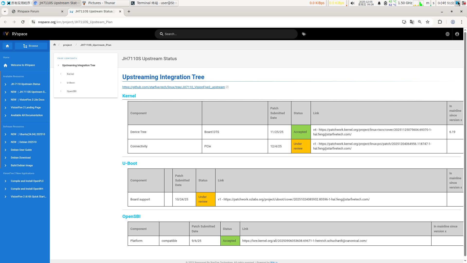

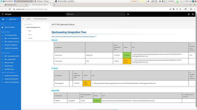

JH7110S Upstream Status & Chromium 142
Does this only cover the things which are different from JH7110? The JH7110 Upstream Plan contains a lot more items, and some are still not done (HDMI for example).
jh7110, I guess that’s about it.
If it could have passed, it would have passed long ago.

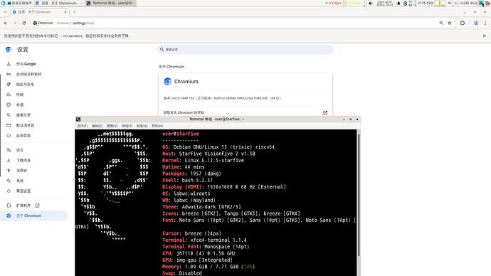

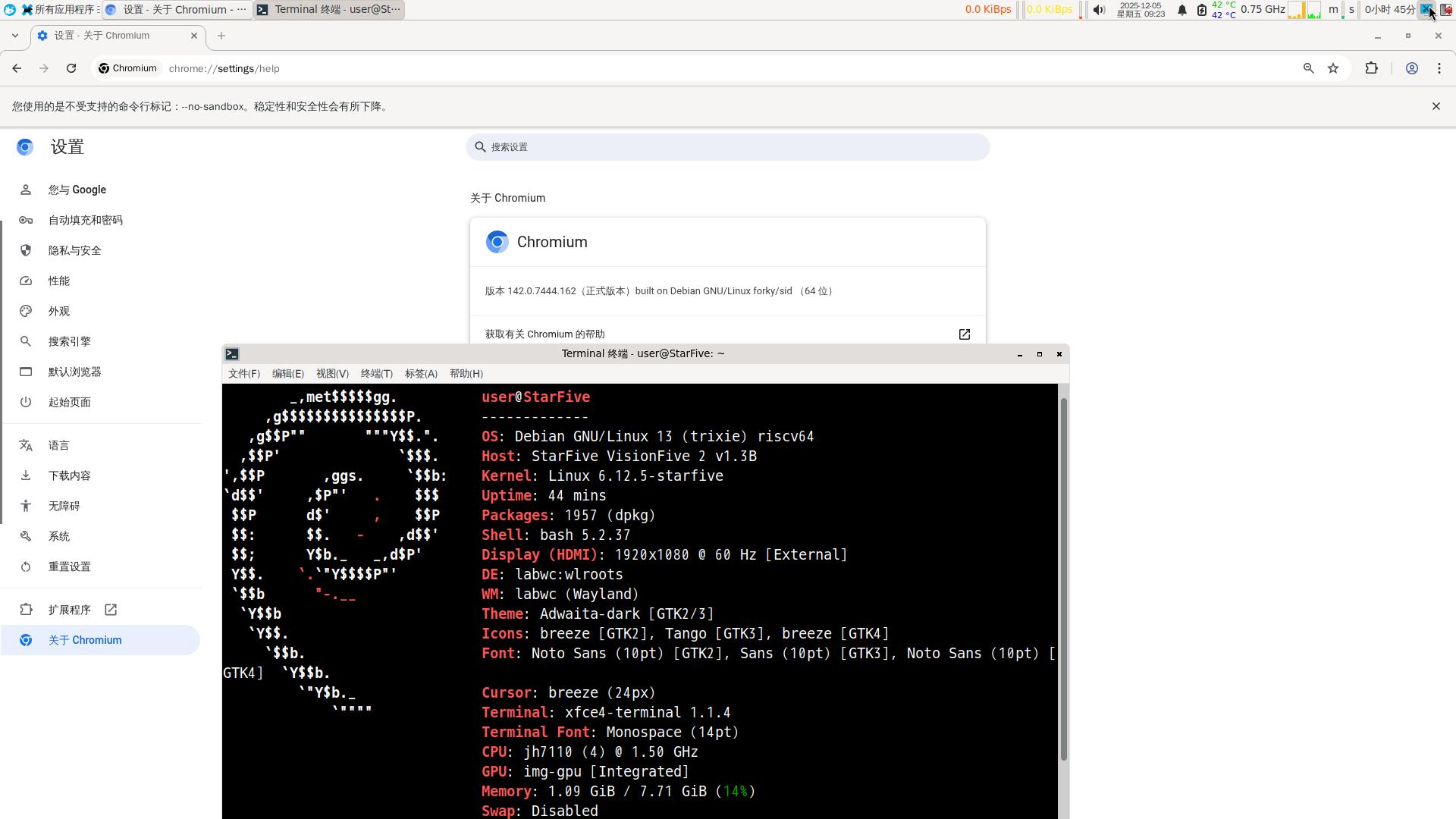

With Starfive doing the maintenance, I am not worried.
Moreover, many OSs’ HDMI and GPUs can work normally. For example: archlinux-ctw irradium deepin
I have been using Linux 6.6.20-starfive + Debian 13 (unstable) for almost a year, and Linux 6.12.5-starfive + Debian 13 (stable) for 2 months. Both are very stable.

JH7110S is just a cheaper version of the same SoC JH7110 (probably binned differently). Therefore, components missing for JH7110 upstream will continue to be missing for JH7110S. Specifically, regrading graphics, the upstreaming effort of HDMI/DC8200 from starfive is pretty much stalled, and the only ongoing effort is from Icenowy Zheng: Oh noes! For GPU, we can only hope that someday somebody will do it (probably never). Recently the driver for IMG BXM-4-64 in TH1520 has been upstreamed in Linux kernel: Oh noes! So, technically it’s possible, just question about who’s willing to spend the time and effort to do it.
