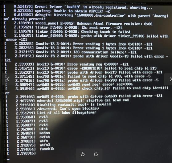

It tries to boot, but it hangs (see picture).
Is there anything I can try?
this is a problem with the old bootloader in spi, solution:
mount the sdcard partition /dev/mmcblk0p3 in create a boot folder and copy all the contents of this partition there.
edit the file /boot/uEnv.txt replace rootdev=UUID=32539e08-a5c0-4084-9f32-0932043d95e3 with rootdev=/dev/mmcblk1p4

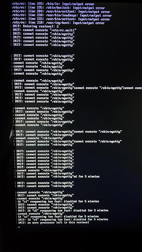

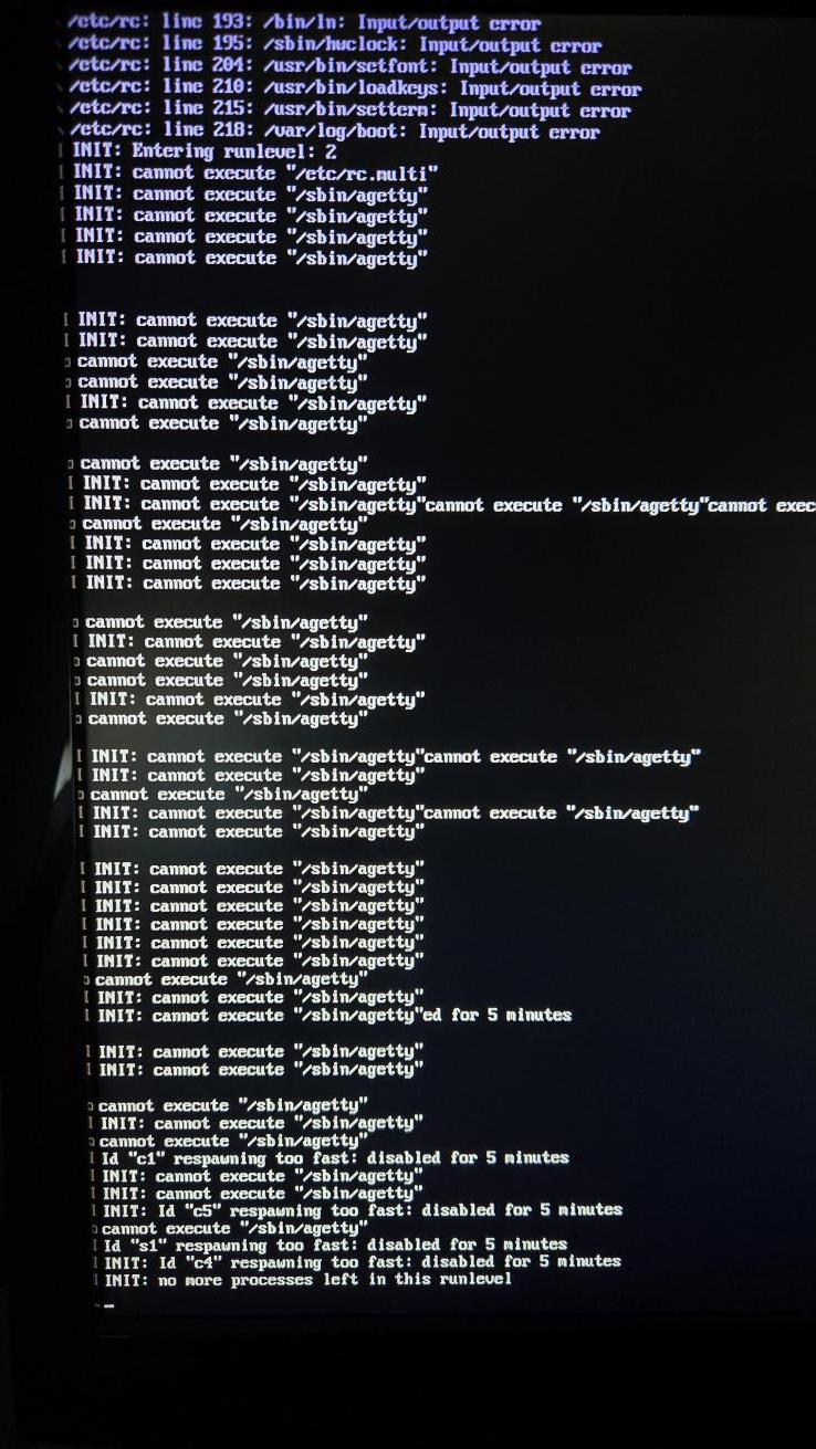

I do get a bit further, but it still encounters issues.
It looks like the FS has errors, I think I found what the problem is, I’ll fix it and post new images.

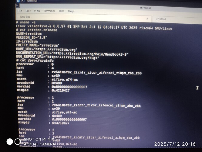

Startup boot successful.The uboot in Flash is debian2409.Select SD on the startup switch,VF2 can directly enter xfce4 when turned on.
