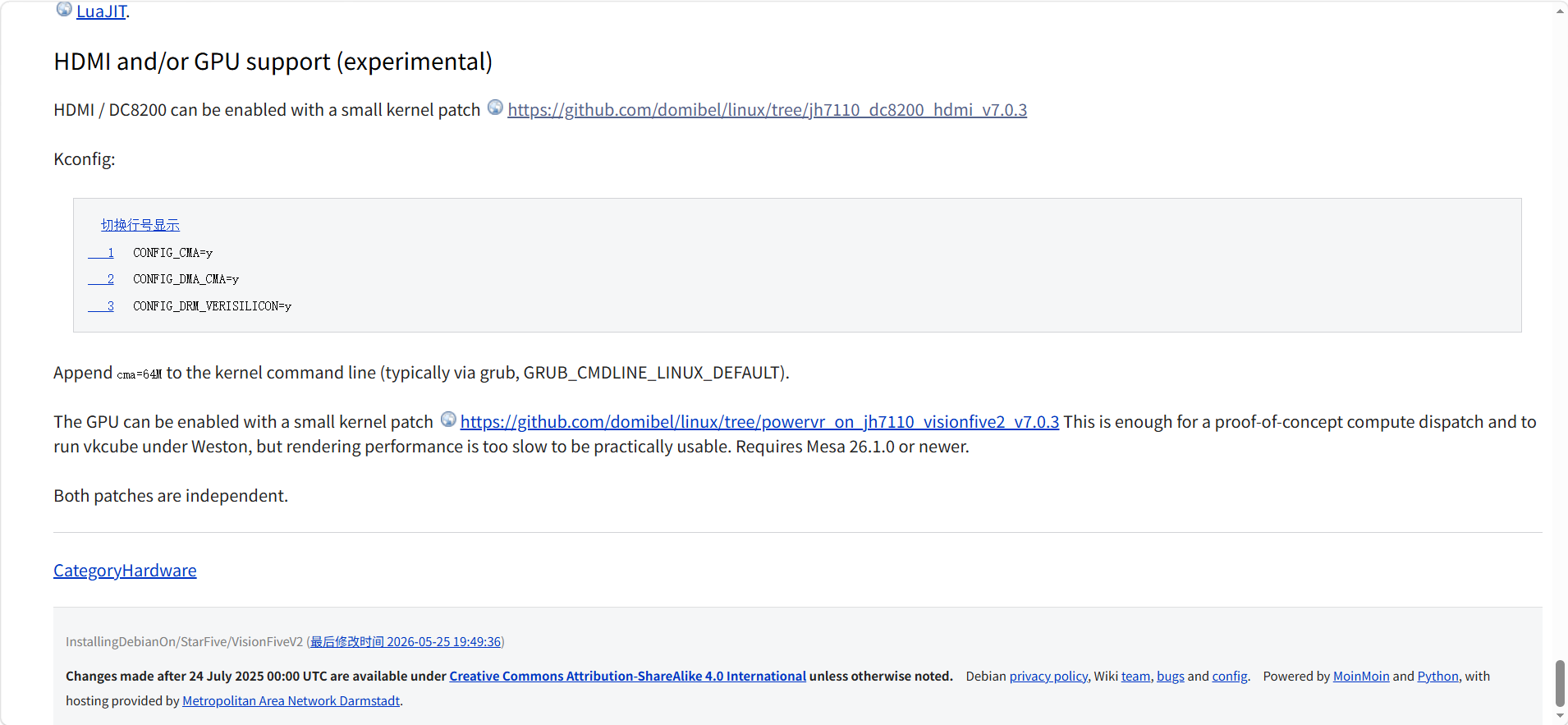

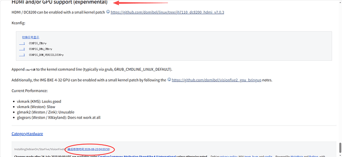

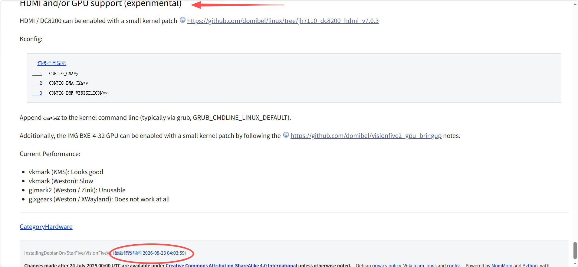

HDMI and/or GPU support (experimental)
InstallingDebianOn/StarFive/VisionFiveV2 - Debian Wiki

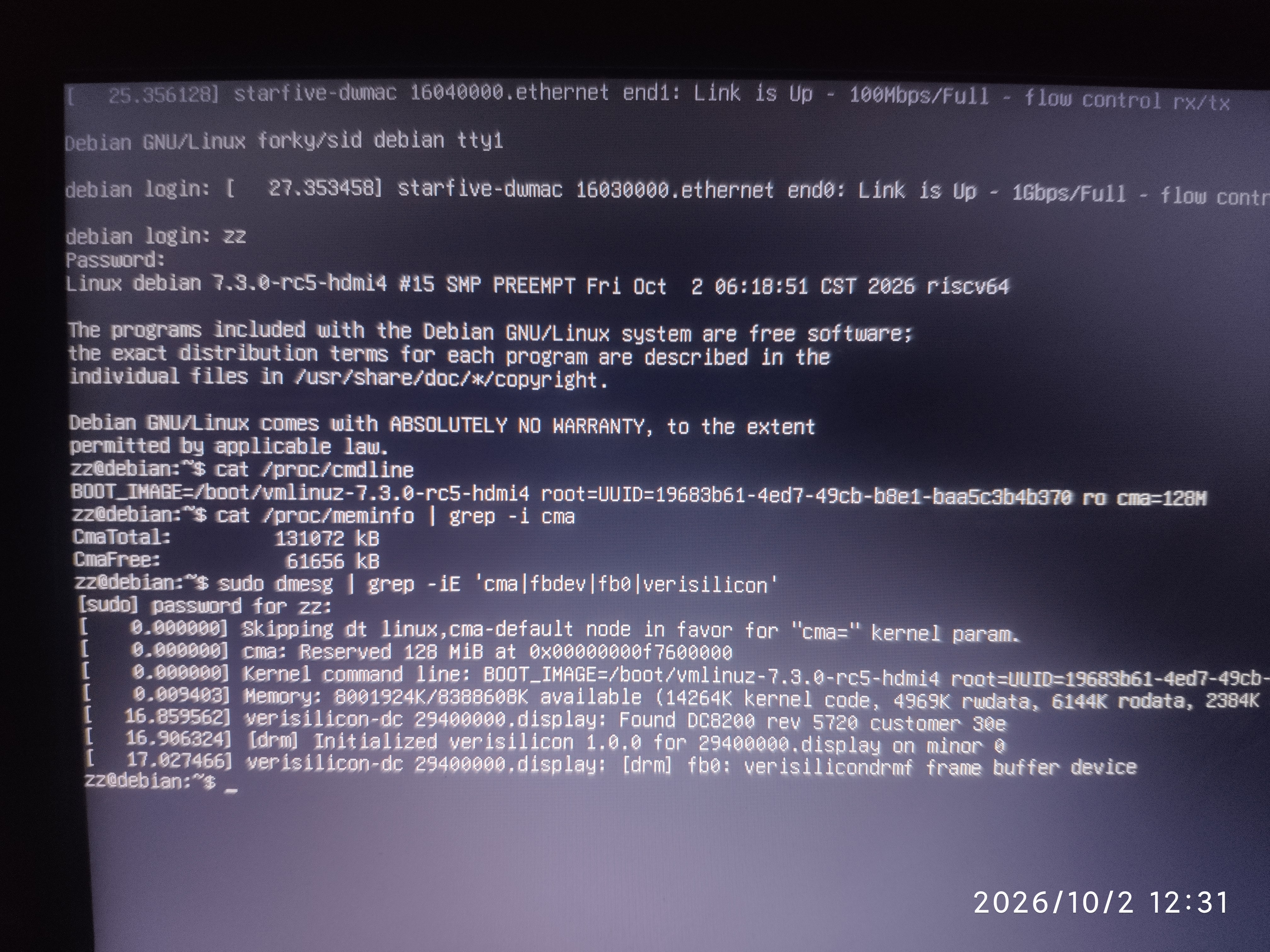

debian13.5(not starfive-debian), UEFI starts, runs on USB drive, with HDMI output。
Using your kernel, the next step is to improve the operation of GPU VPU。
Starting starfive_debuan202510 with UEFI

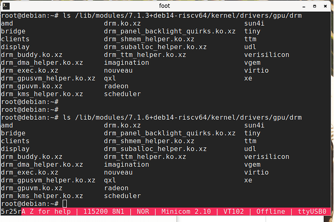

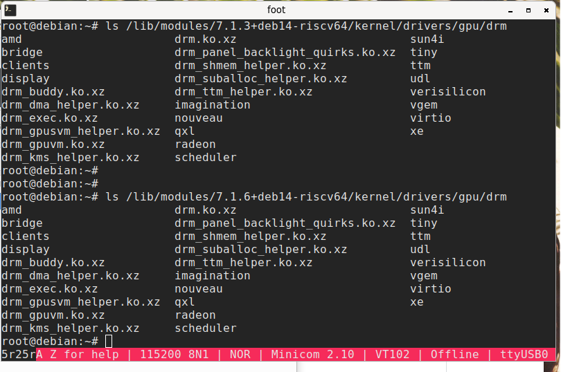

In the kernel modules of Debian 14 for vf2(kernel 7.1.3) and Debian Sid for vf2(kernel 7.1.6), There are two xz compressed files, one in the imagination directory and the other in the verisilicon directory.They correspond to the GPU and HDMI manufacturers of the vf2.
So the Debian developers… :heart_eyes:
Although using them didn’t light up the monitor connected to the VF2, they still made me really happy.

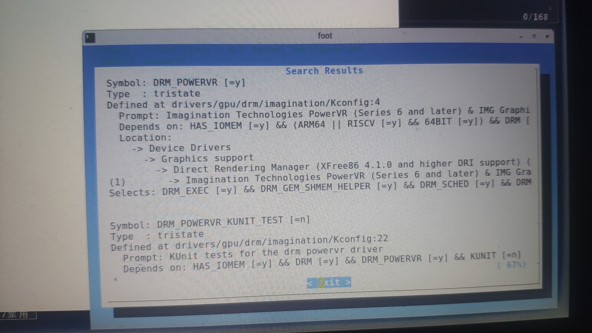

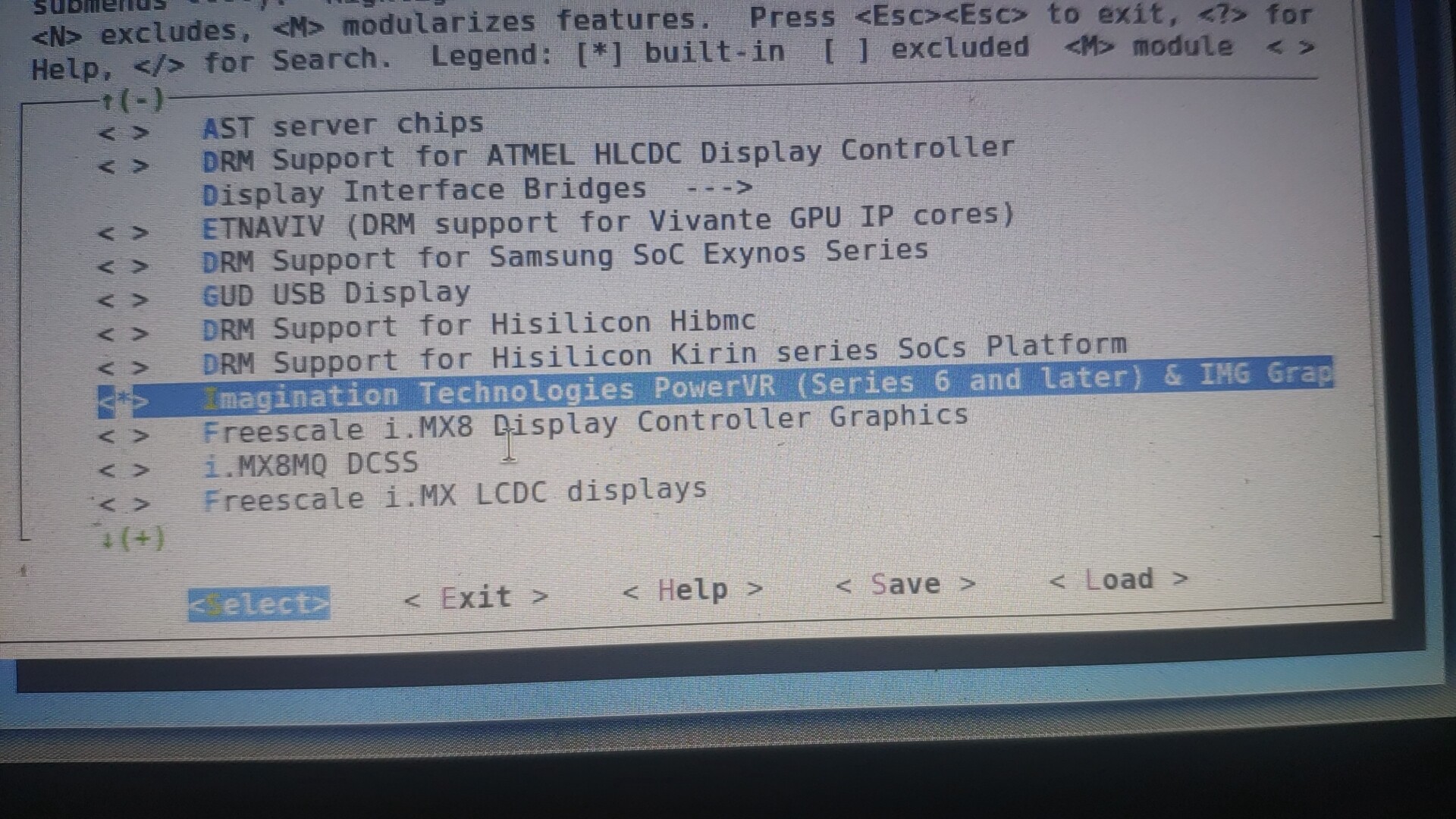

I am not sure whether the patch, to add support for the IMG BXE-4-32 GPU to the existing Imagination driver, is really included in Debian’s linux-image-riscv64. I do not see it in their Linux build repo: https://salsa.debian.org/kernel-team/linux/-/tree/debian/latest/debian/patches
That Imagination driver is in mainline Linux since several years, but it does not support the GPU of the JH7110.

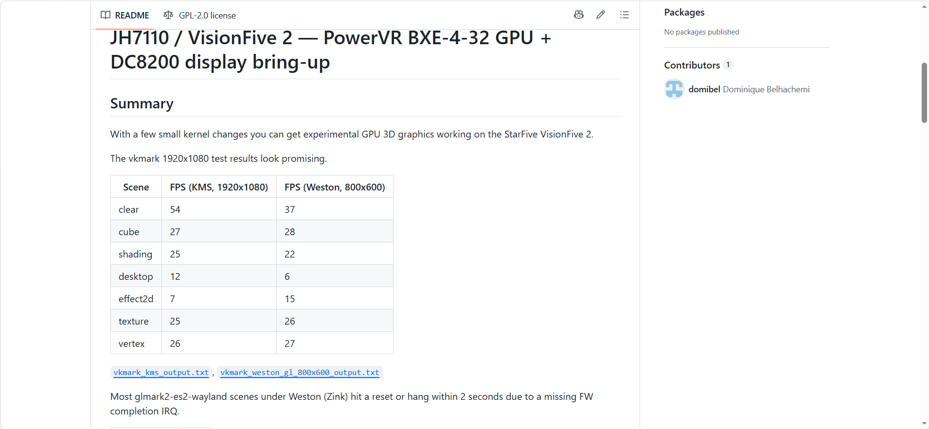

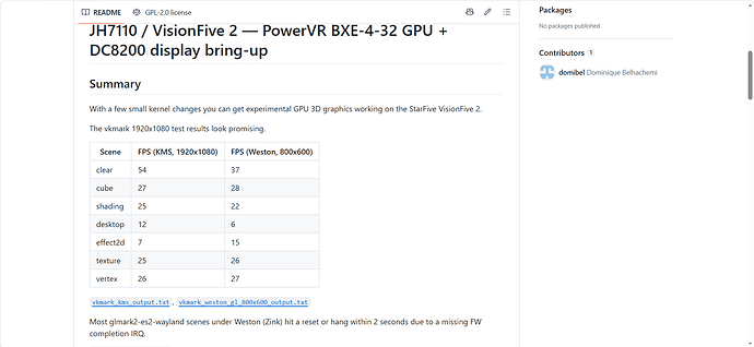

domibel/visionfive2_gpu_bringup
no HDMI output · Issue #1 · domibel/visionfive2_gpu_bringup

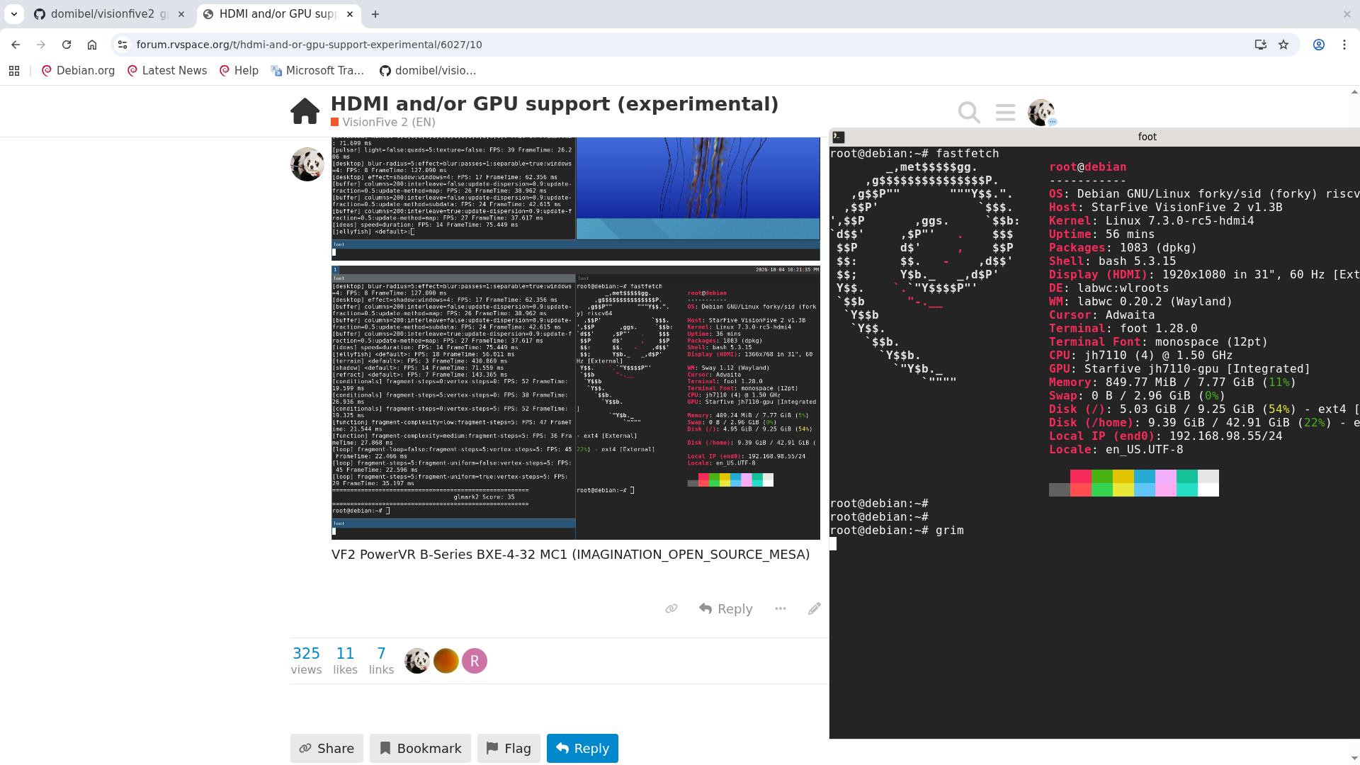

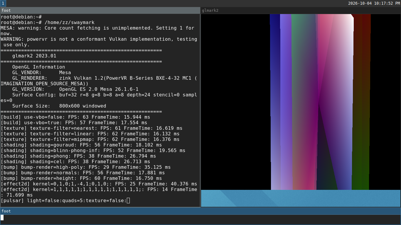

VF2 PowerVR B-Series BXE-4-32 MC1 (IMAGINATION_OPEN_SOURCE_MESA)

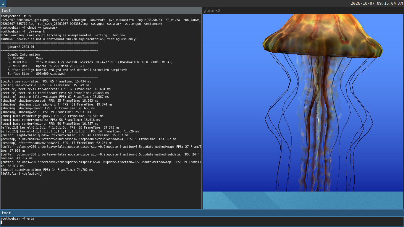

Kernel 7.3.0-rc5 + debian 13.7 + mesa 26.1.6-1
labwc
sway

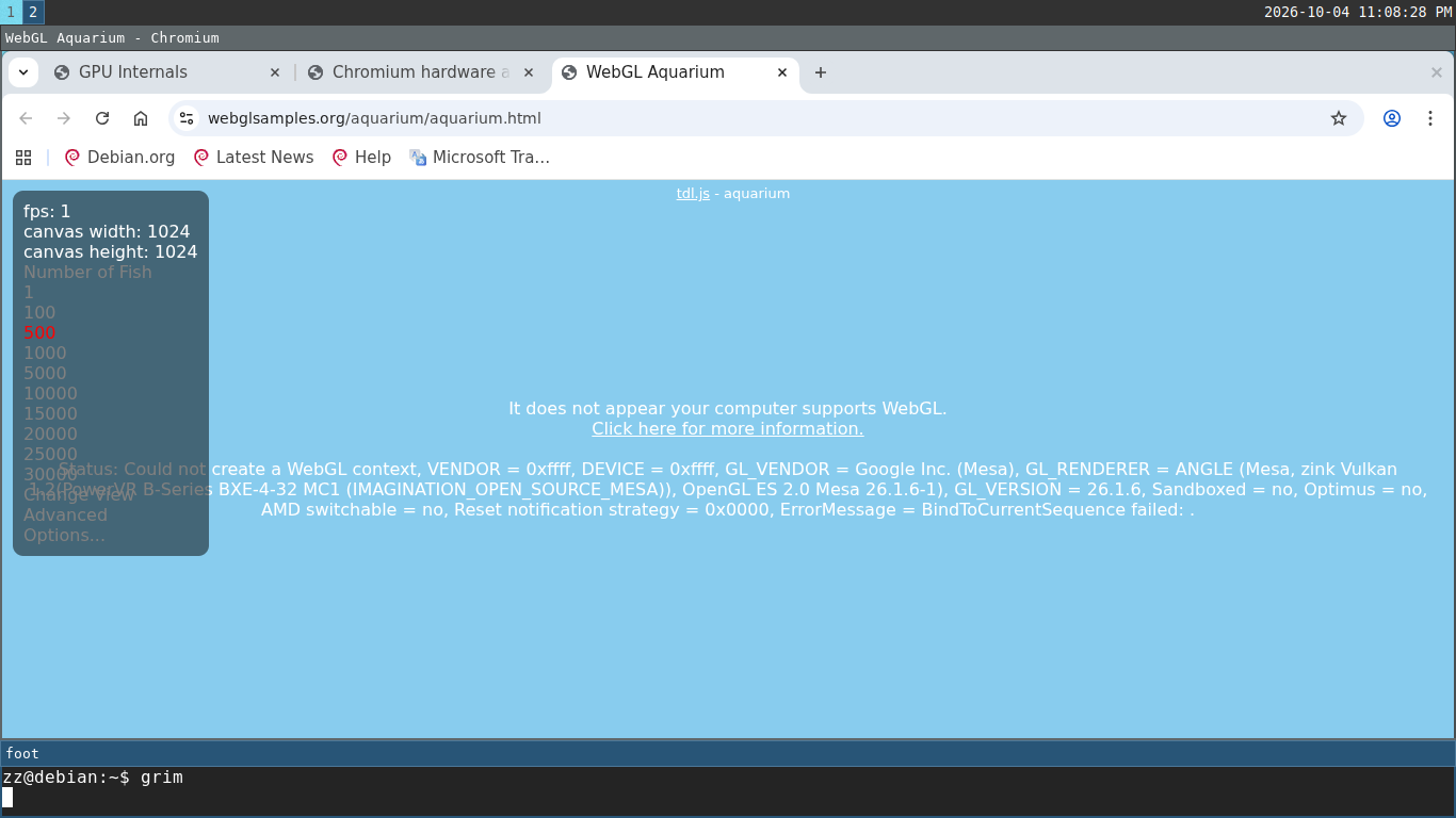

So all that work to get aquarium running at 2 FPS with 1 fish?
I am not the author or developer. If you have any questions, you can leave a message on GitHub

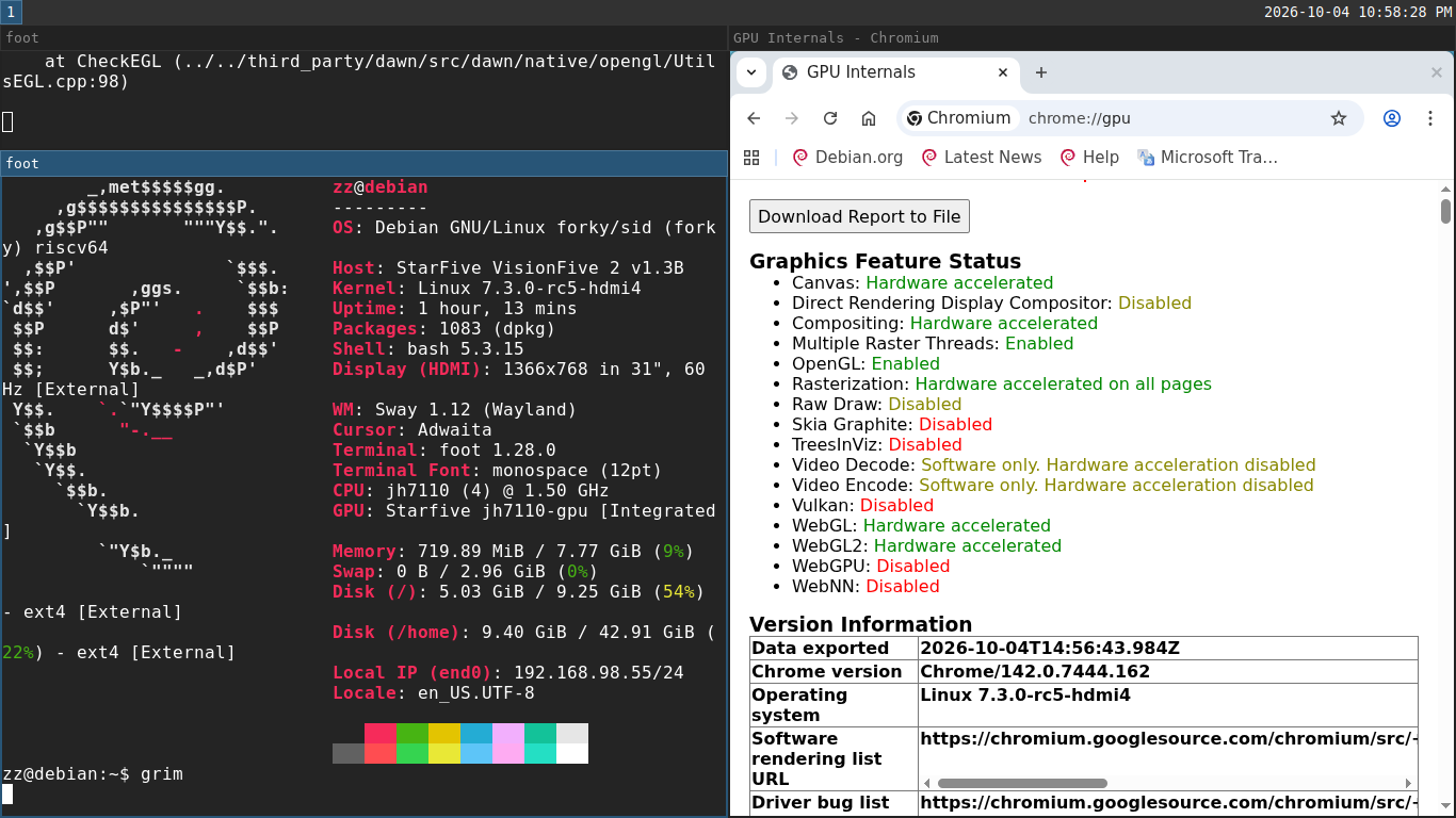

Have you made any special settings for Chromium?I must set the variable ANGLE_FEATURE_OVERRIDES_ENABLED=exposeES32ForTesting to enable WEBGL.
