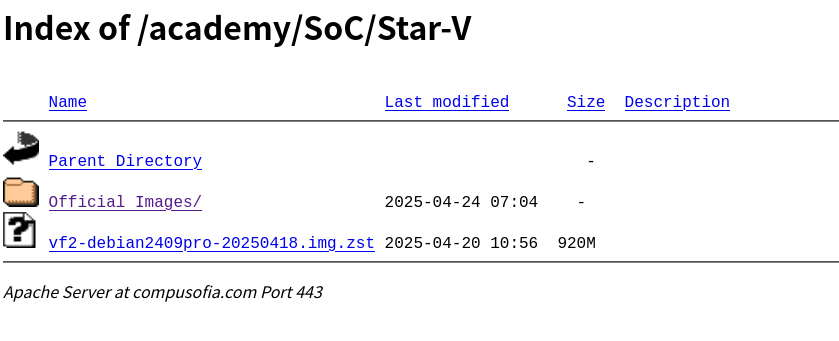

The image is here:
https://compusofia.com/academy/SoC/Star-V/Official%20Images/
burn with “dd” to some drive and go on

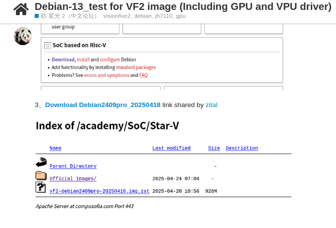

I am very pleased to see that you have already used the debian2409pro. I saw it in your download link. Can I share the debian2409pro downlooad link on your website?
sorry, “baidunetdisk” It is provided for Chinese netizens to use. :grinning:
you can share what you want :slight_smile:
Thank you, I have already shared.
