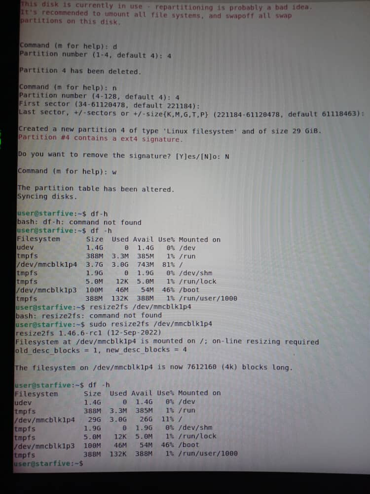

  2. Extend partition on SD Card
    This part also seems to work well.

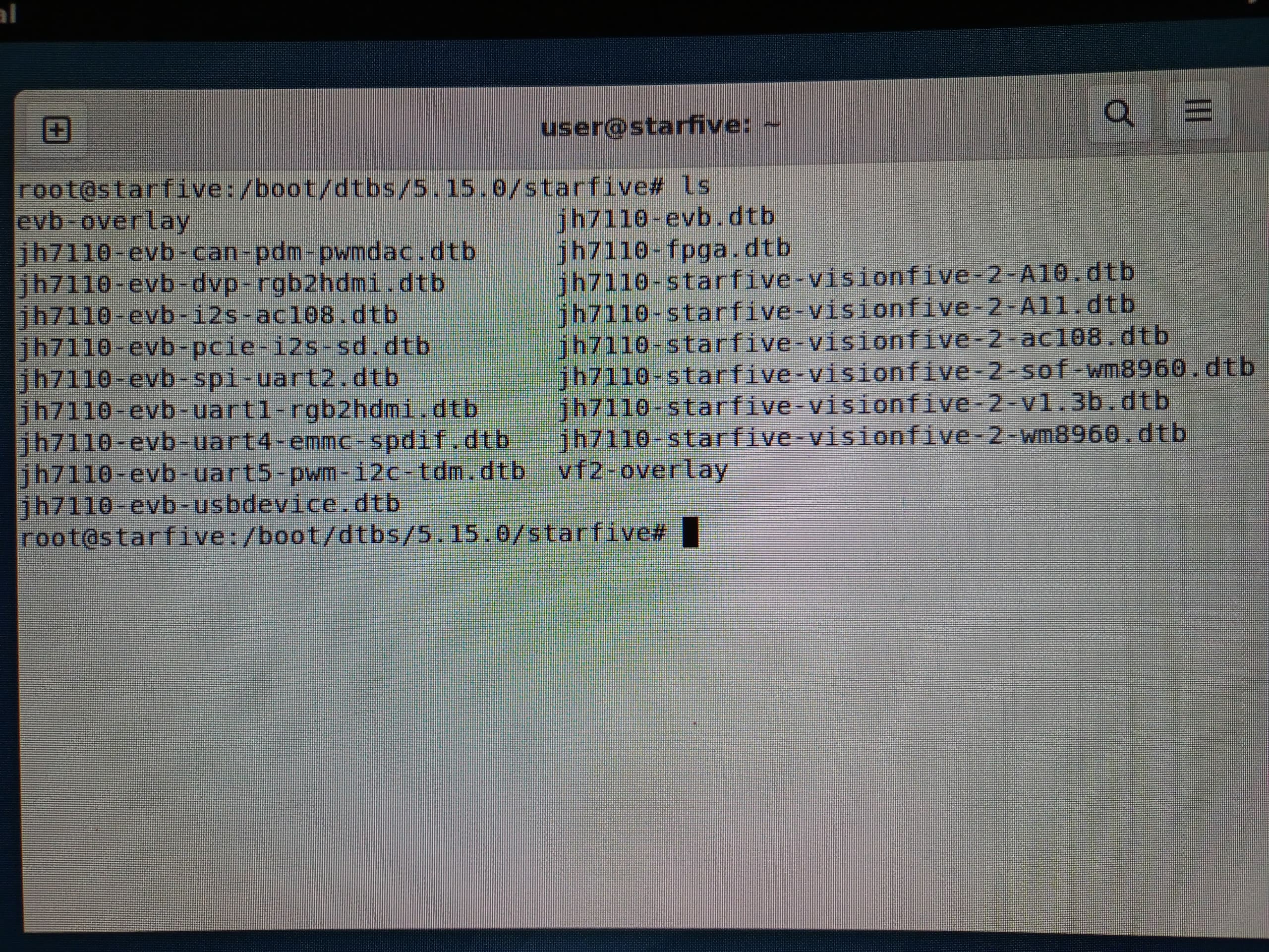

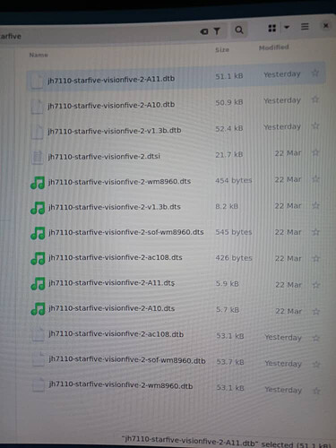

this is the content inside my arch/riscv/boot/dts/starfive:
i replaced some of the commands following the naming convention of the files inside my board.

I also copied some more dtb files from the downloaded linux folder from Github (GitHub - starfive-tech/linux) to /boot/dtbs/new/starfive following the content inside the existing /boot/dtbs/5.15.0/starfive:
