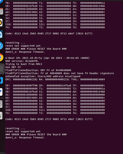

## Issue SPL loads firmware but reports “DBT FV at 0x40840000” followed by “FV corrupted” I can verify the FV header exists at 0x840000 offset in my firmware with hexdump showing: - _FVH signature - Valid GUID - FDT signature (0xd00dfeed)
while booting on board i got this error
