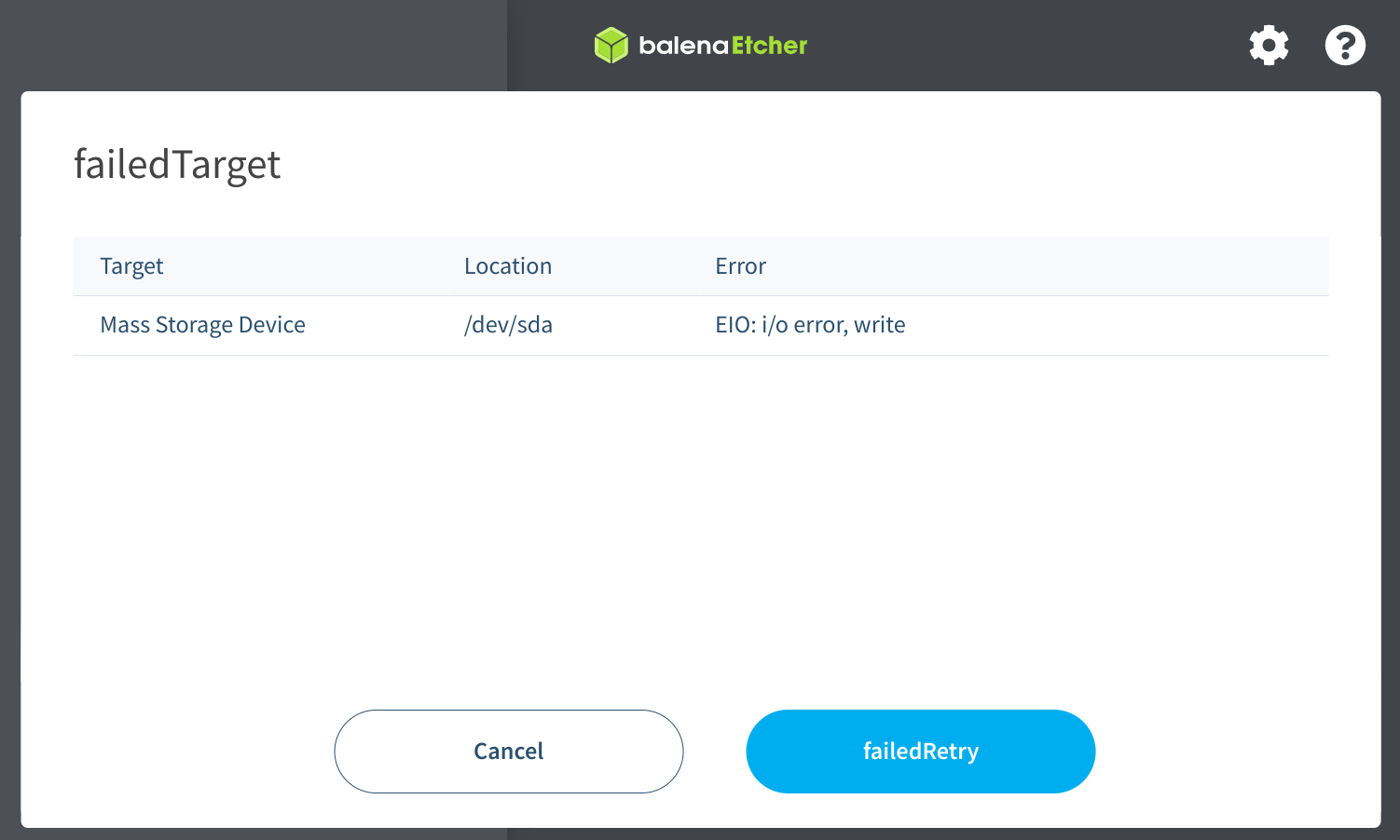

I’m trying to use balenaEtcher to flash starfive-jh7110-VF2-SD-wayland.img to a micro-SD card, but I get the above error message. I’m using Slackware Linux and the i3 window manager.

Now the previous error is gone, but the flash failed anyway:
Ah, sorry if that only half-fixed your issues, looks like a permissions issue or bad hardware, I guess that if you try starting Baena from a terminal you may get better diagnostics via the output there.

I bought a new SD card reader, and it works fine. Thank you all for your help!
