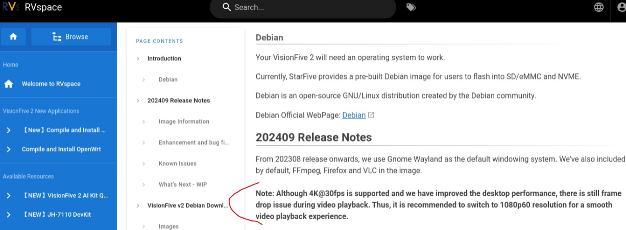

When connecting a 4K monitor via HDMI2.0, the maximum achievable refresh rate is only 30Hz in the Debian Display settings. Is this behavior normal? I have noticed that it can decode 4K@60FPS.
https://rvspace.org/en/project/VisionFive2_Debian_Wiki_202409_Release

I am just an old user of VF2. My personal guess is: 4k@60 This is the highest parameter that VF2 hardware devices can achieve,But now, many of the supporting software for the RISCV architecture are not yet complete, including drivers and operating systems.

Driver issue.
There is no opensource driver. All OS which support 3D are using closesource driver.
