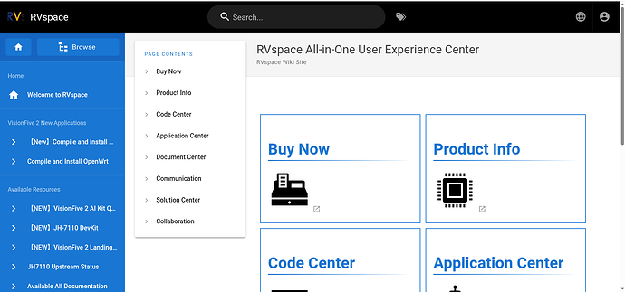

RVspace All-in-One User Experience Center | RVspace Accessories recommended for purchase by Starfive
This page has a document centre, there might be the information you need.
