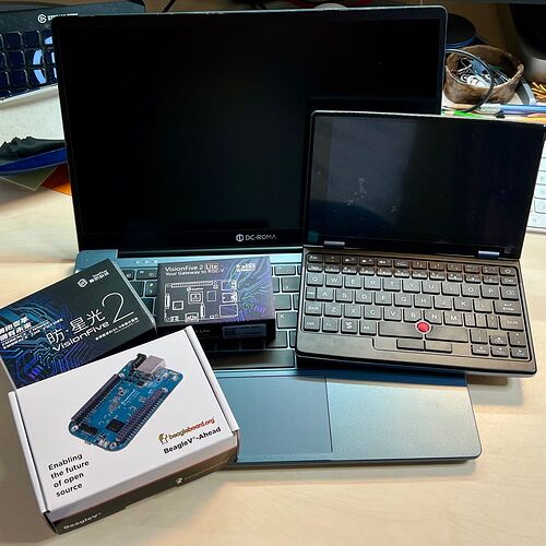

VF2 Lite delivery confirmed.
That image makes It looks like you could almost fit two VF2L boards into one VF2 box :slight_smile:
It is only the plastic shipping boxes though.
In reality the actual VF2 PCB (Printed Circuit Board) is only ~1.5 times the size of the VF2L PCB.
VF2L: 85 mm x 56 mm (3.35 inches x 2.2 inches) - standard Raspberry Pi form factor.
VF2: 100 mm x 72 mm (3.94 inches x 2.83 inches) - standard Pico-ITX form factor.
P.S. I do wonder if any of the RPi cases will work on the VF2L, it would be odd in some ways but nice in others (¥/€/£/$).
