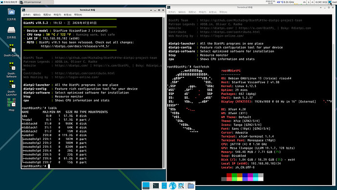

I am an end user in China. I am not familiar with development and I don’t English, so I will try to keep my answers brief.
This is the boot error message after selecting the grub menu. I don’t know how to find the log records.
yes.The system with “uefi boot XXX” is always like this.
The grub configuration file is automatically generated by update-grub.
YES, The official version of debian13 is installed on /dev/nvme0n1p8. /dev/nvme0n1p1 is /boot/efi.
I’m not sure if it’s the same USB stick. I used two for testing. I will use the same USB stick to retest the two DietPIs in a few days and then inform you of the results.
grub will not modify /boot/extlinux/extlinux.conf。
After constructing the menu in grub, I corrupted extlinux.conf, resulting in a failed boot process.
I guess, QSPI → efi → grub → uboot, so most systems that were originally booted by uboot, can now be booted by grub.
My nvme:
/dev/nvme0n1p1 = /boot/efi
/dev/nvme0n1p2 = archlinux-cwt /boot(Original image partition 3)
/dev/nvme0n1p3 = starfive-debian202510 /boot (Original image partition 3)
/dev/nvme0n1p4 = archlinux-cwt / (Original image partition 4)
/dev/nvme0n1p6 = starfive-debian202510 / (Original image partition 4, Upgraded to debian13.5, GPU VPU is working properly)
/dev/nvme0n1p7 = starfive-debian202510 /home
/dev/nvme0n1p8 = debian13.5 / (The official version was installed through debian ISO on a USB drive)
I have modified /boot/extlinux/extlinux.conf and /etc/fstab on nvme.
So, if my nvme capacity is large enough, I can install various system images that were originally booted on uboot onto nvme and boot them through grub.
The menu of Grub not be displayed on the monitor, but I can modify the default startup value of Grub to boot the required OS.

You are correct. Replaced a USB stick. :+1:
Great, so something is wrong with the other USB stick, or the board/bootloader/kernel is a bit picky/prone regarding USB slot connectivity/power or something.
