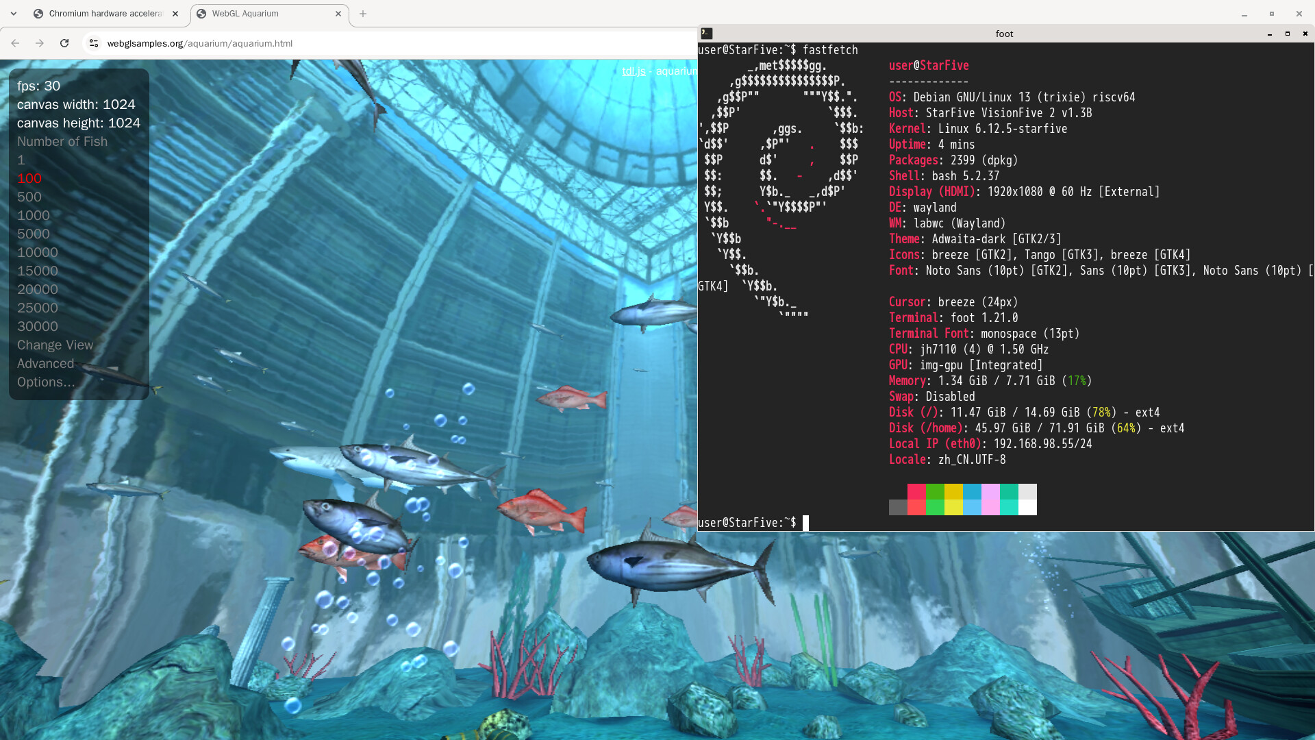

After upgrading to Debian 13.7

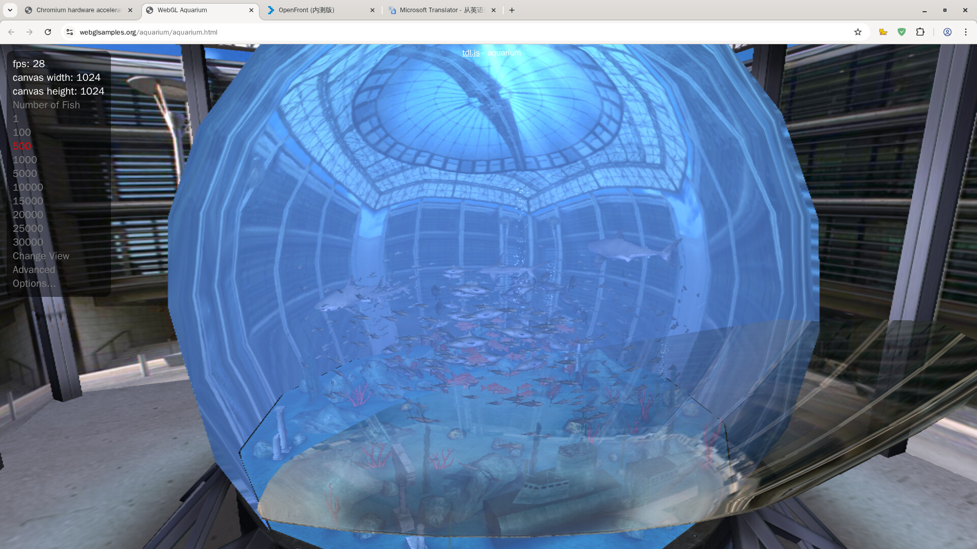

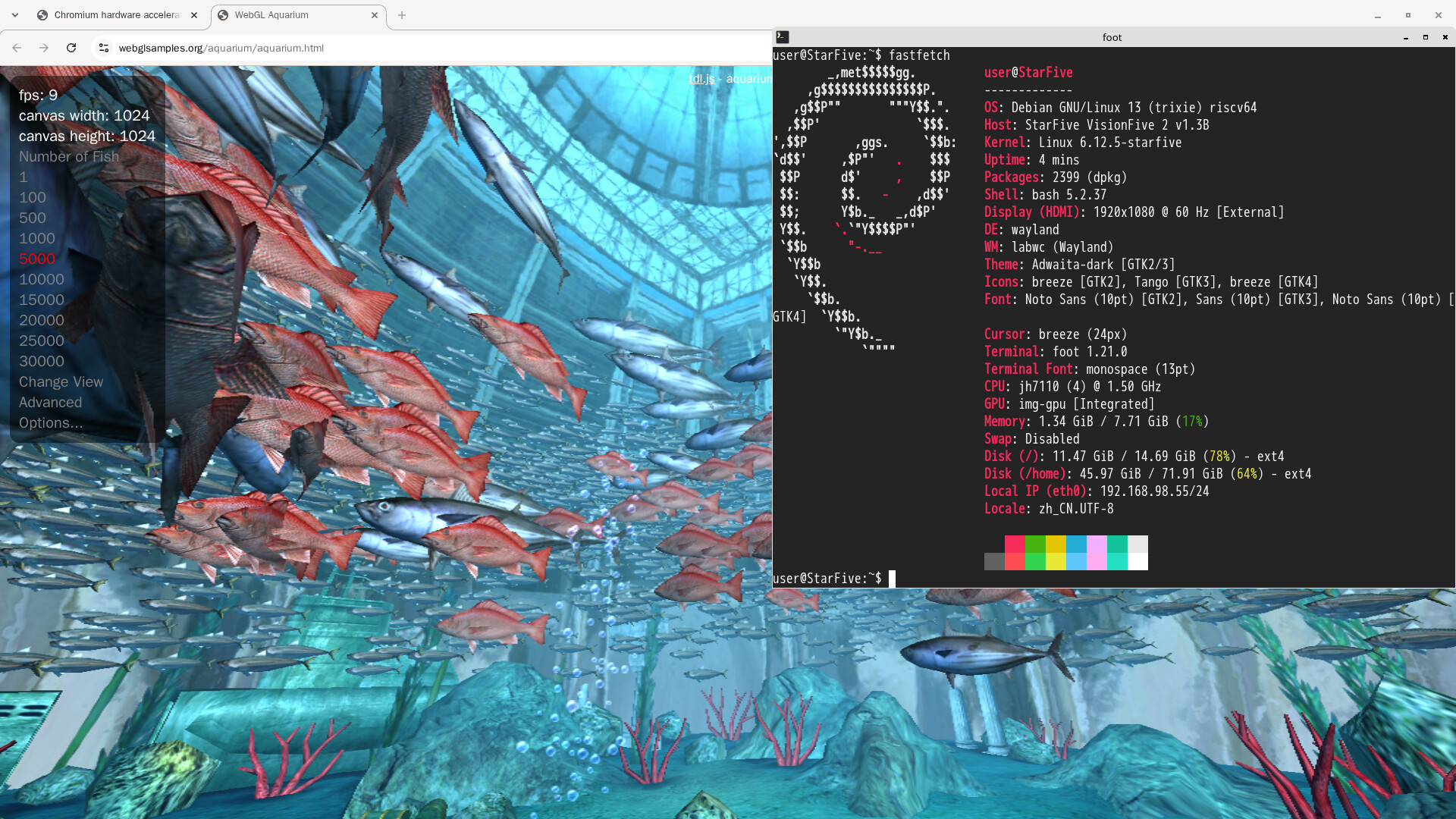

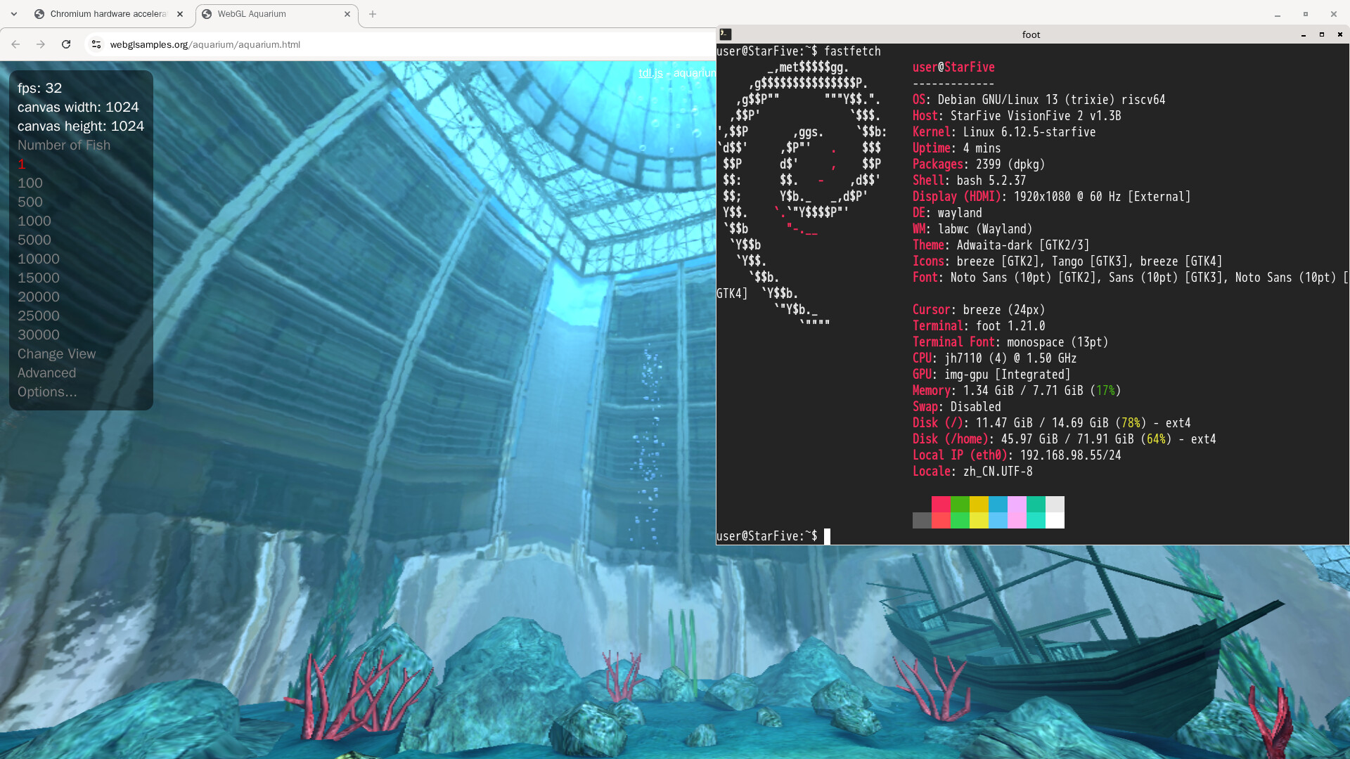

Interesting. Can you test WebGL Aquarium?

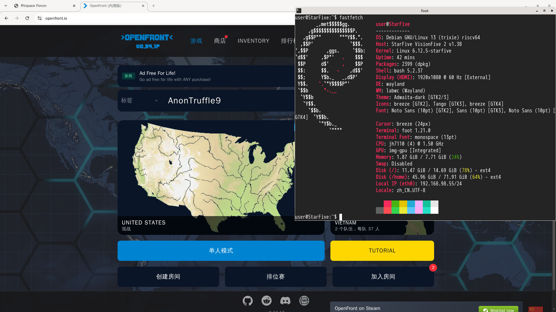

I also played the game https://openfront.io/.

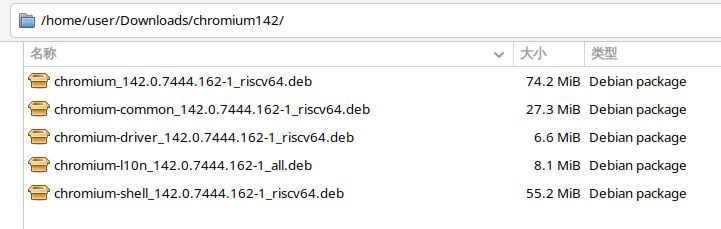

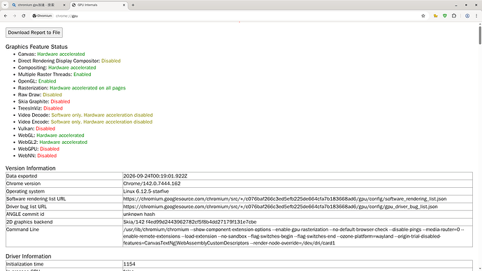

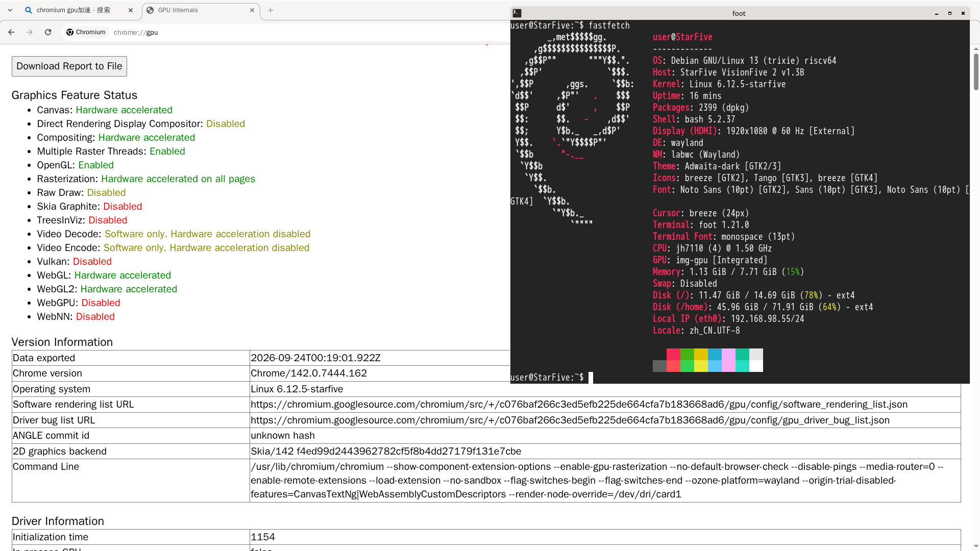

LivingLinux,If you need chromium142, please give me an email address, and I’ll send you the deb package.
I’m not sure if I can receive emails larger than 100MB.
Can you upload to WeTransfer and share the link?
1、Unique Download Link | WeTransfer ;https://wetransfer.com/previews/de2fafd58f5a9cdef1049ce1e88b95e220260924123101/3bfa7a?itemId=dcedf96266e6989d99b2fd0f6c8b0c6b20260924123247

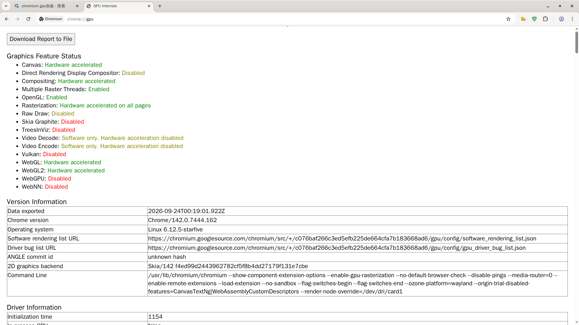

2、Browser startup: chromium --no-sandbox
3、Need to upgrade debian202510 to debian13.7, Releases · starfive-tech/Debian please refer to update-from-bookworm.png on the release
4、Before upgrading debian13.7, it is necessary to back up/boot/all files. After the upgrade, the backup files need to be overwritten to ensure that the GPU works properly.

I mean your chromium 142 build.

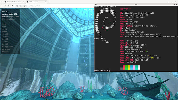

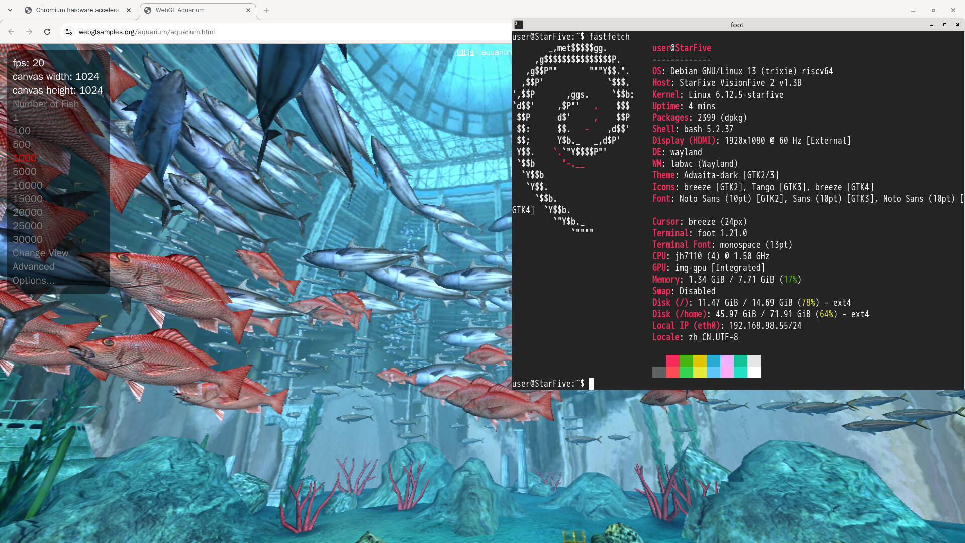

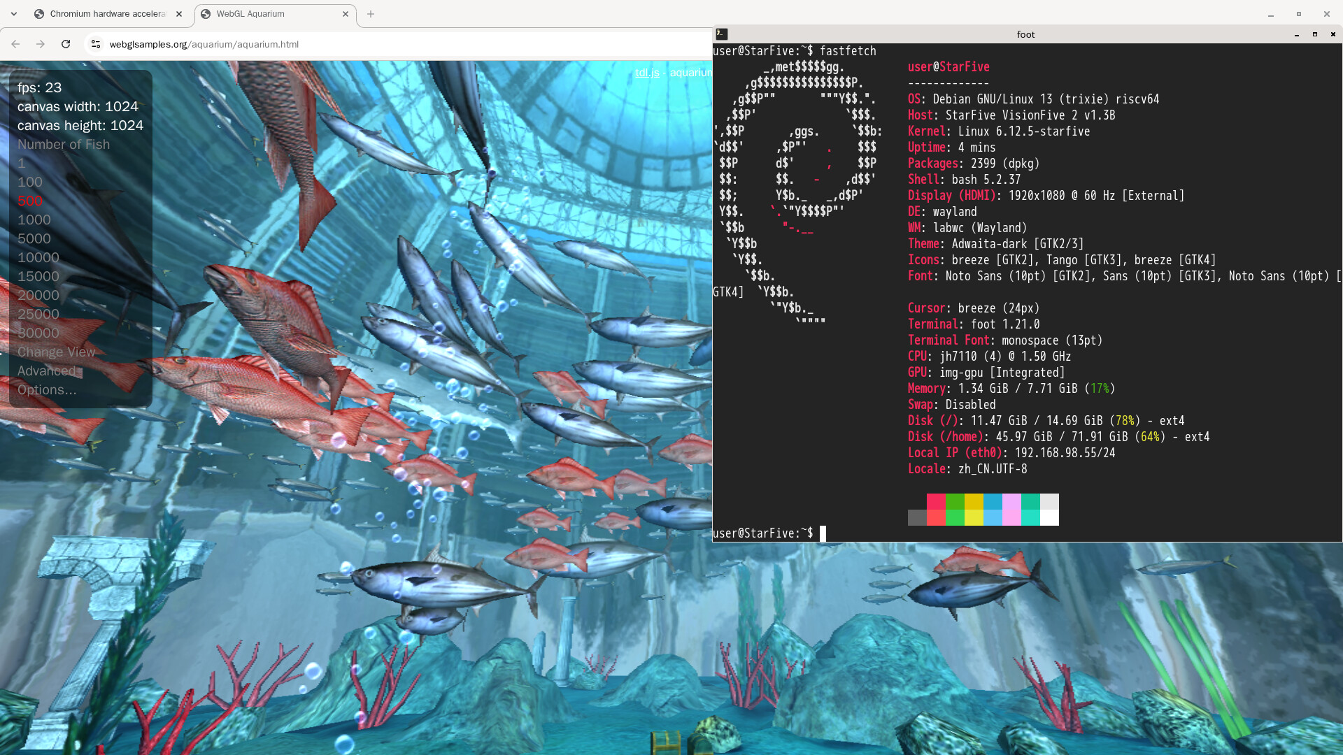

Does it run with the same speed with 6.12.111-r0b0 as it does with 6.12.5? 23fps with 500 fish in the aquarium?
I did not test 6.12.111+chromium142. I guess 6.12.111+chromium142 is hardware supported(Need to upgrade system components to debian13.7).

Additional note: The deb installation package for chromium142 was not compiled by me. I downloaded it from a Riscv software package website in Changzhou, China last year. This website has been closed for over six months and I can no longer find its URL.
补充说明:chromium142的deb安装包,不是我编译的。是我去年从中国常州市的一个riscv软件包网站下载的,这个网站已经关闭了超过半年,我再也找不到它的网址。
