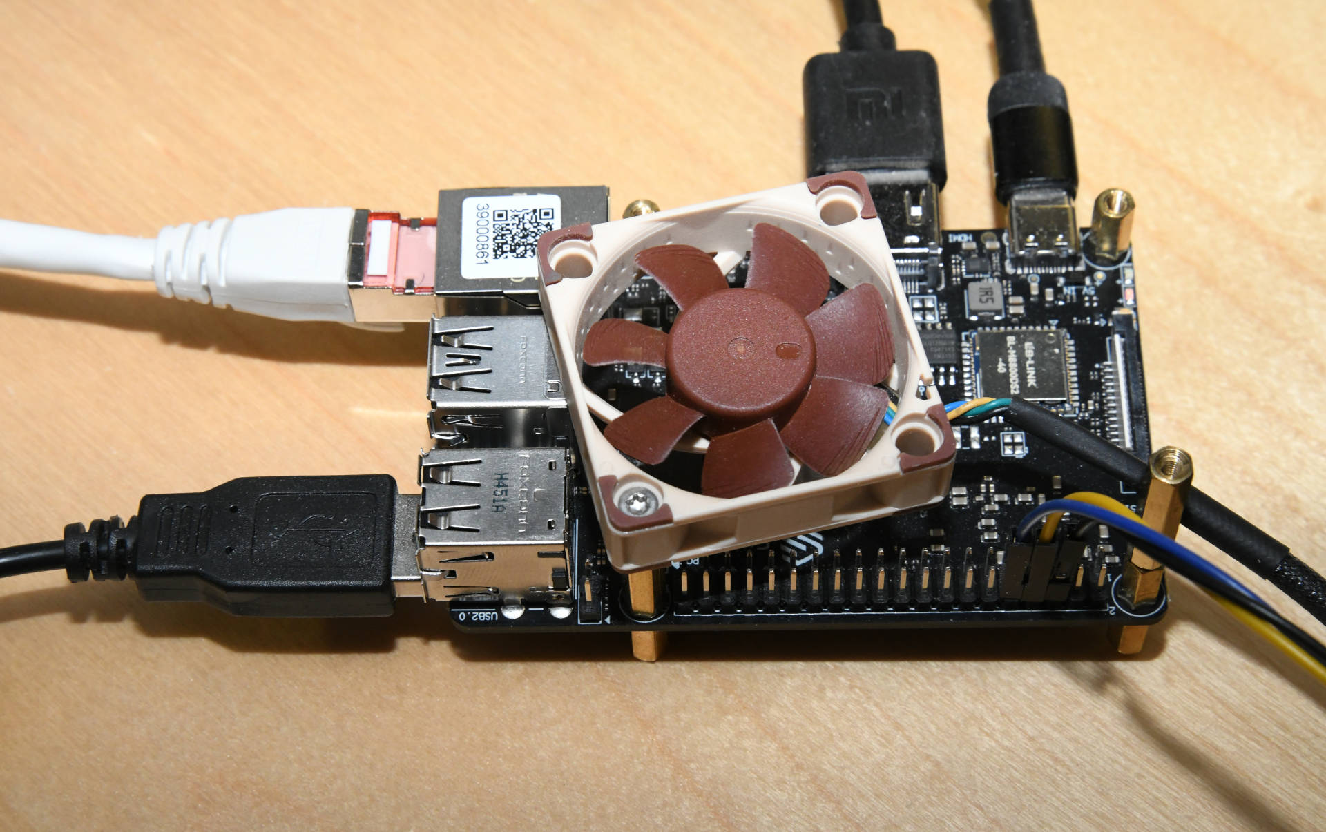

I have stress tested both boards for more than an hour with zstd and xz (I can’t tell how much extra heat the GPU would use, I don’t use it due to performance/driver issues).
The VisionFive 2 reaches about 76°C (at an ambient temperature of 24°C, with a small heatsink/fan mounted, but the fan not turning, in an enclosure which is open at the top). The mounted SSD reaches about 70°C.
With the fan spinning, the temperature is well below 50°C at full load.
The VisionFive lite reaches about 63°C (on standoffs, sea picture below). I can’t tell about the SSD temperature, the current SSD doesn’t report it (or the drivers and software in Ubuntu can’t read it out).
With the fan spinning, the temperature is 45°C at full load.

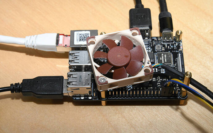

To cool the VisionFive lite, I mounted a small 40mm 12V fan from Noctua using M 2.5 standoffs and powered it with a USB adapter from Noctua (Noctua doesn’t allow this from a technical point of view, because the fan is 12V).
Very cool trick the way that you are mounting that fan.
A simple trick for higher natural convection cooling is to mount the board vertically off the ground to improve laminar airflow. That way there is less resistance to natural air flow (hot air rises) on both sides of the board.
Another improvement to that is to mount a fan directly below the board which is still vertical, blowing cold air up, that way you are cooling both sides of the PCB which is in effect a large copper heat sink. And you are gaining a minute amount of extra cooling aided by natural convection.
