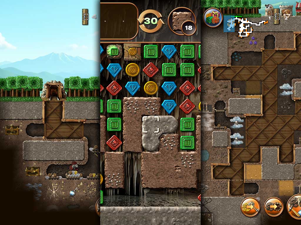

Bemined - I have ported my game to RISC-V (testers welcome?)
I’ve been following RISC-V developments for a long time and with VisionFive 2 it looked like desktop-grade board with GPU acceleration finally so I have decided to give it a go and port one of my games to it. The process wasn’t easy (finding correct image, flashing bootloader with UART, fixing the system that lost GPU acceleration all of a sudden after reboot, etc), but finally it is working on my system and I would love to get some testing/feedback on other RISC-V systems/configurations.
The game is a digging/puzzle game.
To install/play:
wget bemined.com/download/Bemined.run
chmod +x Bemined.run
./Bemined.run
The game’s is pretty heavy on the graphics/effects side, so will be unplayable without GPU acceleration.
I have built and tested it on Ubutnu 24.04 @ VisionFive 2, but the game’s engine supports both OpenGL and OpenGL ES, so in theory it should work with discreete GPU too.
From my experience on VisionFive 2 the game lags initially while it loads/processes textures in the background, but once the heavy CPU work is done and it’s mostly GPU that does the work, the experience is relatively smooth even at 1920x1080.
For reference there is also a web version of the game which can be played at www.bemined.com in case you are not sure if what you see is a bug or not.
Would love to hear any feedback! Thanks in advance.

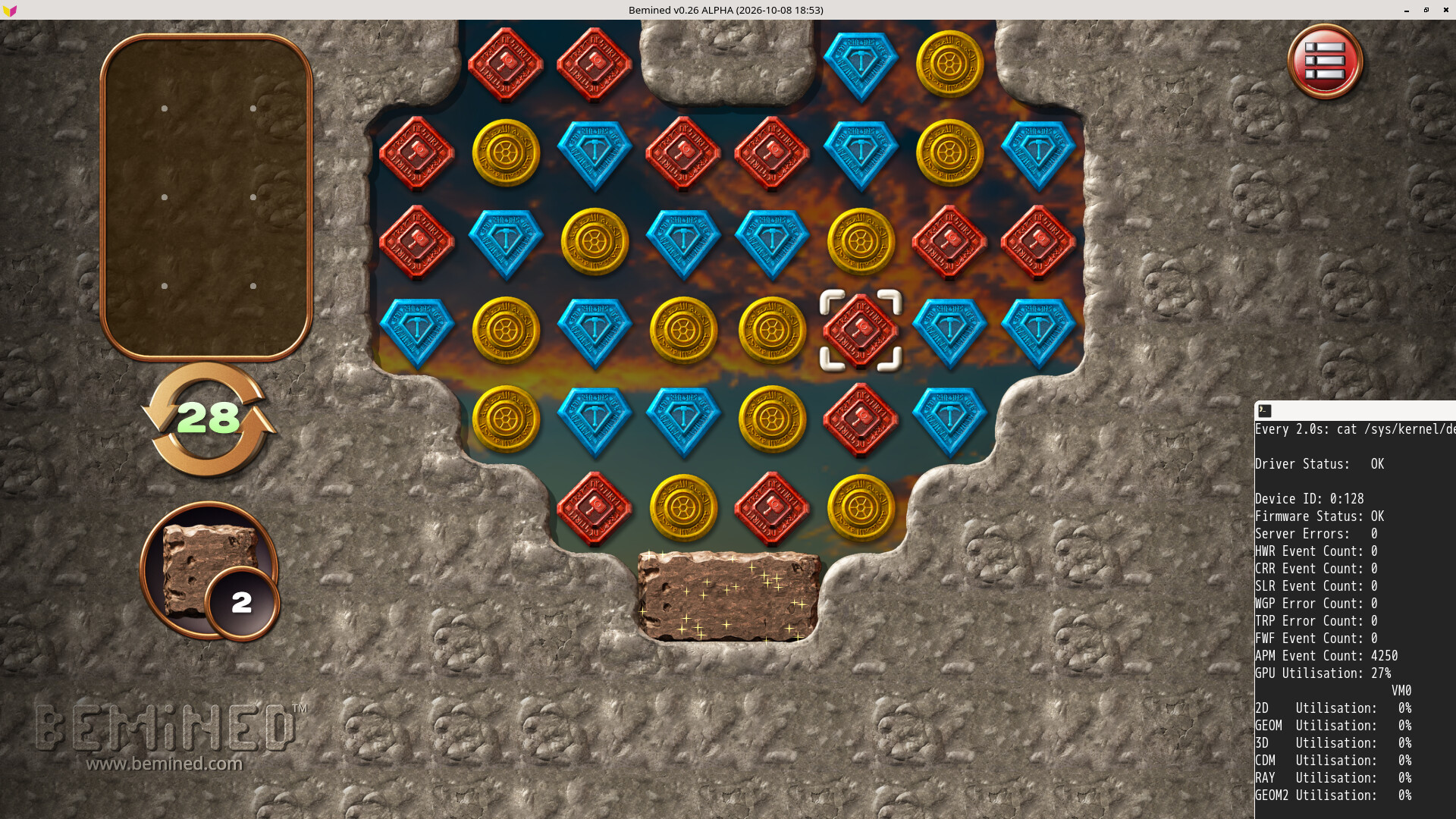

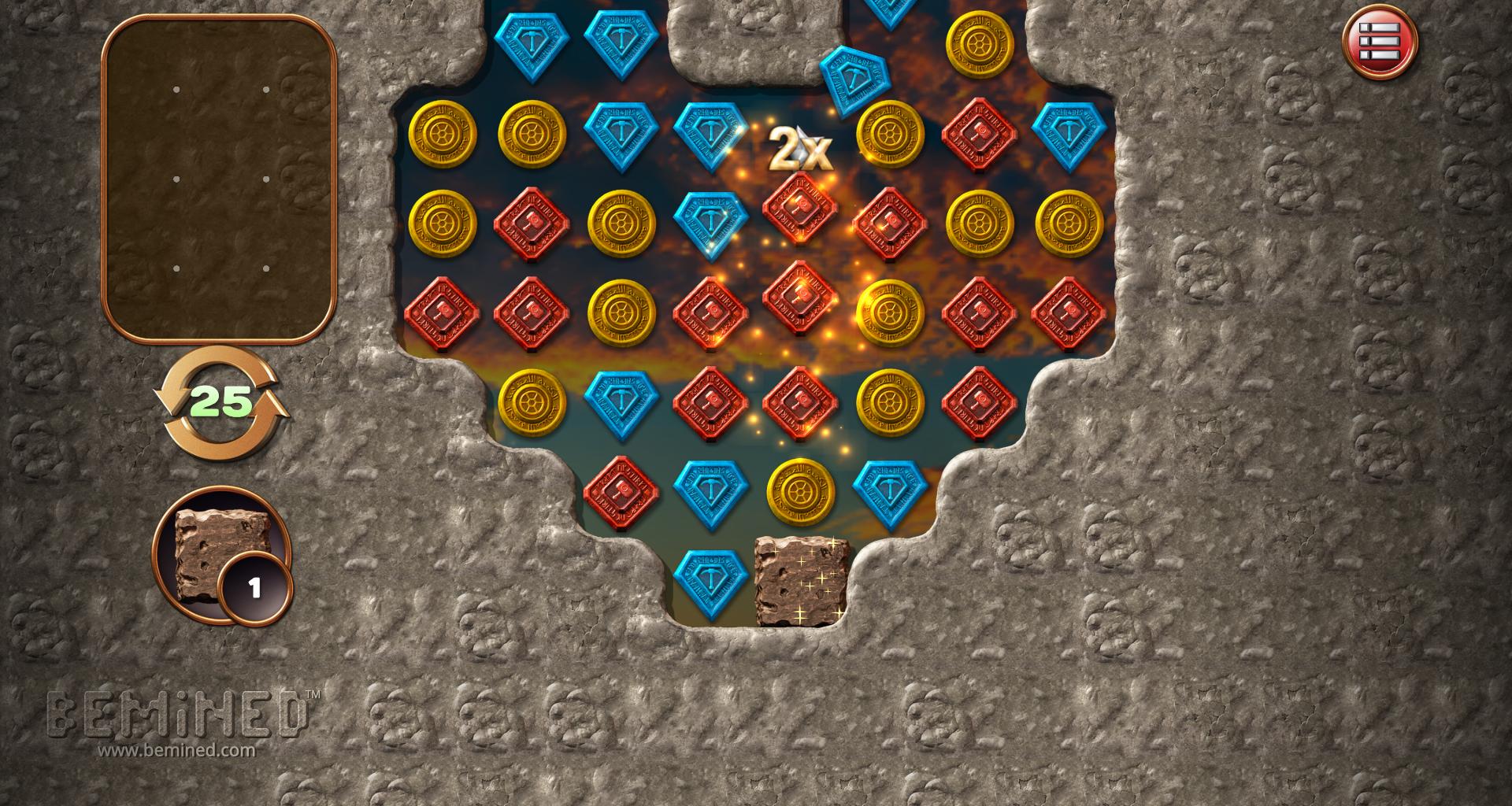

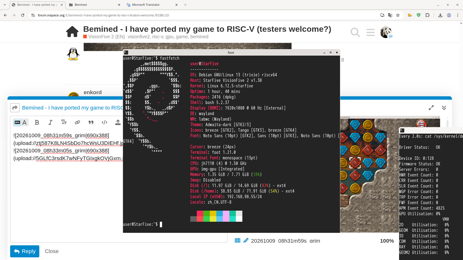

Success!
Thanks! F11 or Alt+Enter can switch full screen mode

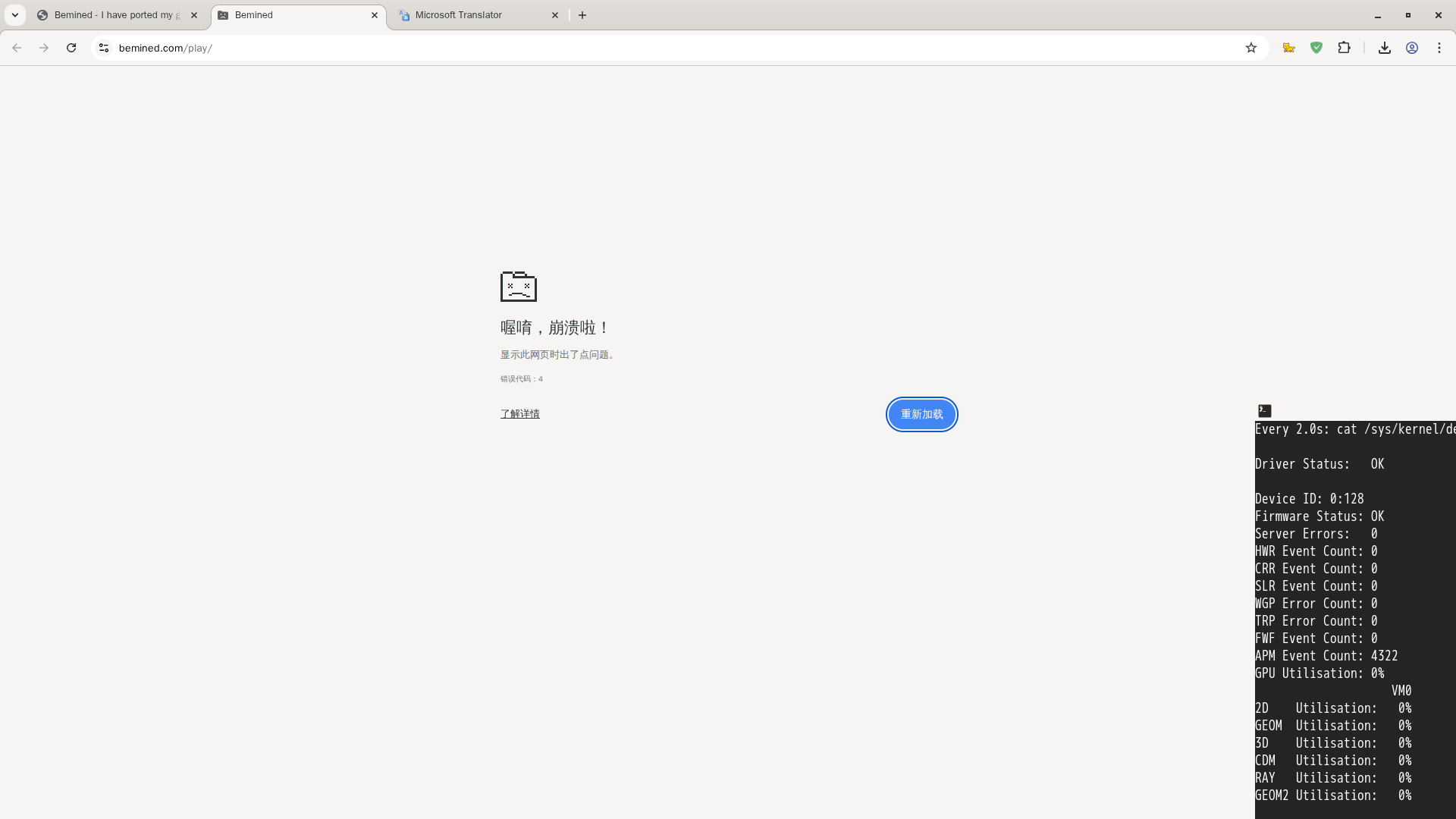

debian202510(Upgraded to Debian 13.7)+chromium142
PS:This game isn’t really suitable to play in China, the internet is slow, and it can take 15-30 minutes just to get into the game. :grinning_face:
Thank you! I am using bunny CDN and looks like they don’t have servers in mainland China, only in HK, probably that’s why it is slow. But it’s only first download is slow. Next updates are incremental, so should be fast.

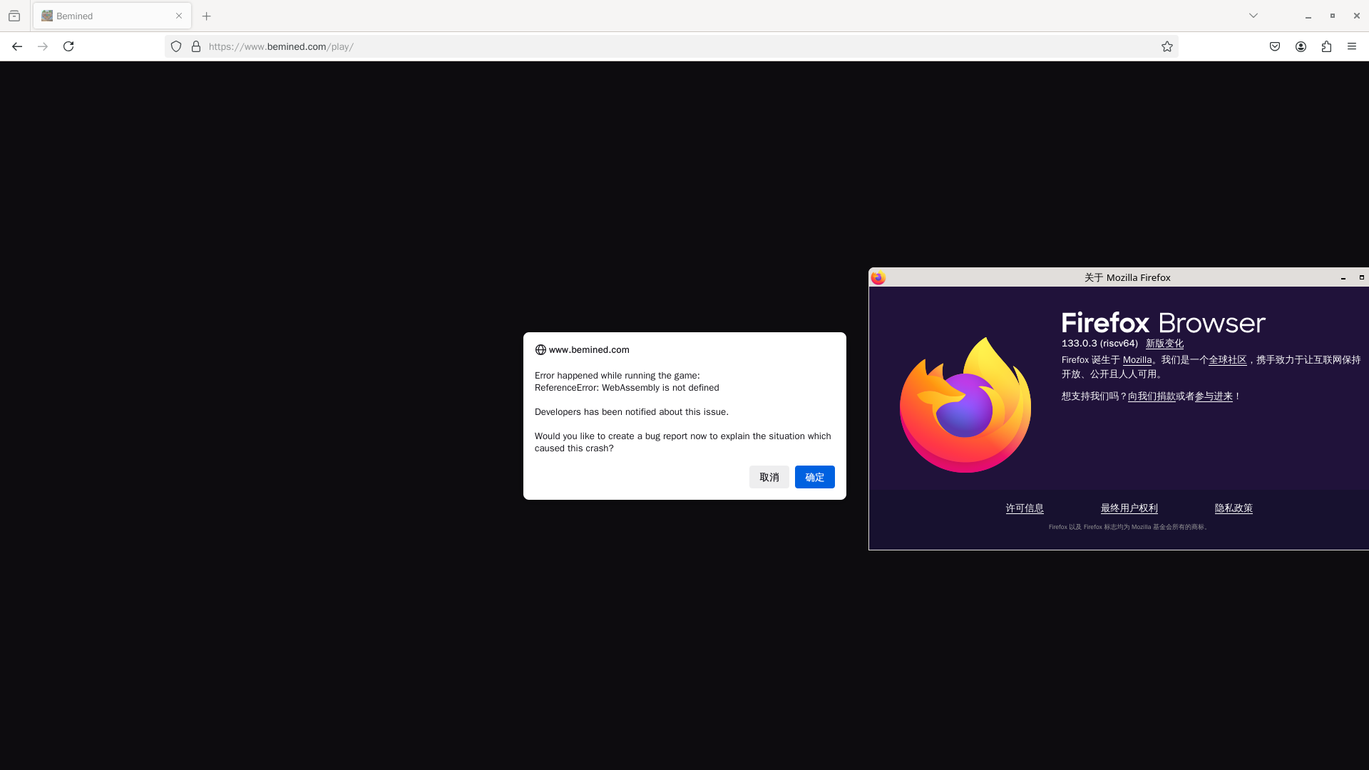

Speaking about browser version, looks like RISC-V browser builds are limited and do not support WebAssembly - I have the same problem in Firefox. Too bad :pensive_face:
The RISC-V chip of the VisionFive 2 (JH7110) is RVA20 profile, and it means that it doesn’t support everything that is expected from a “modern” chip. For instance Google has set the baseline for Android on RISC-V to the RVA23 profile.
